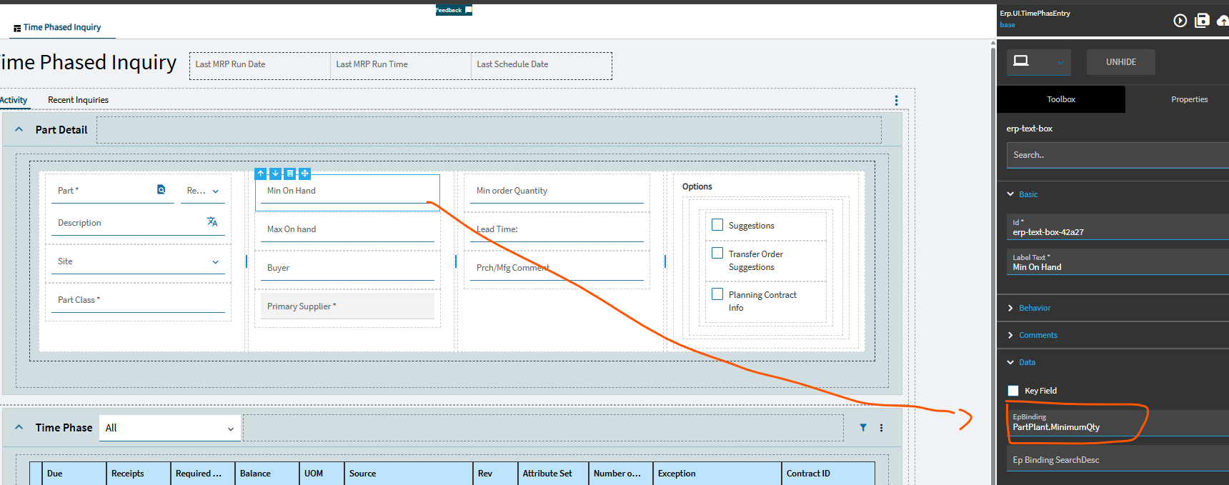

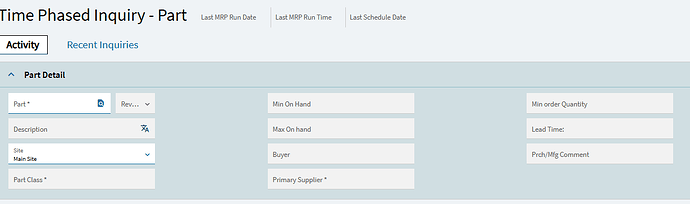

I was able to add some of the data pretty easily using Application Studio. I hid the fields I didn’t need and added some text boxes that need an EpBinding setup. Snips below.
