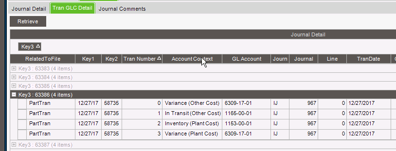

Looking through the WIP/Recon report shows a Variance account getting Credited and debited (same amount) for every PLT-STK (Transfer Order Receipt).
I queried the TranGLC table, and confirmed these are tied to the PLT-STK transaction.
Based on the TranNum in the Journal Tracker, I see that the PartTran:
  1. Debits the variance account,
  2. Credits the In-Transit acct,
  3. Debits the Inventory acct
  4. Credits the variance account.
Why are these net-zero variances being created?

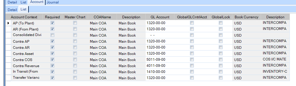

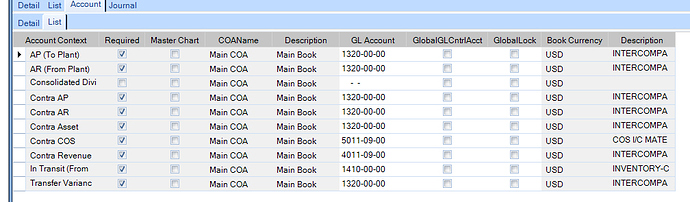

Under your Plant, there are Plant Transfer Definitions. Those are tied to the Plant Transfer GL Controls.
Our general GL accounts for this look like this. We do have some special accounts depending from what plant to STK-PLT and PLT-STK.
