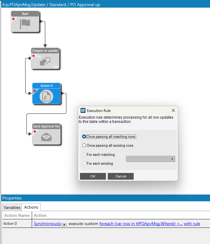

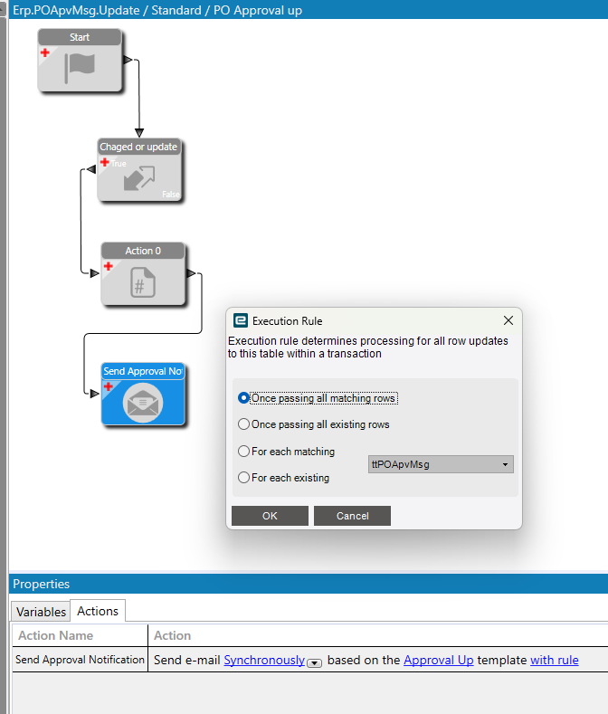

Hello, I know this is quite an old topic… but I have exhausted all the information in this site and still struggling getting this working.

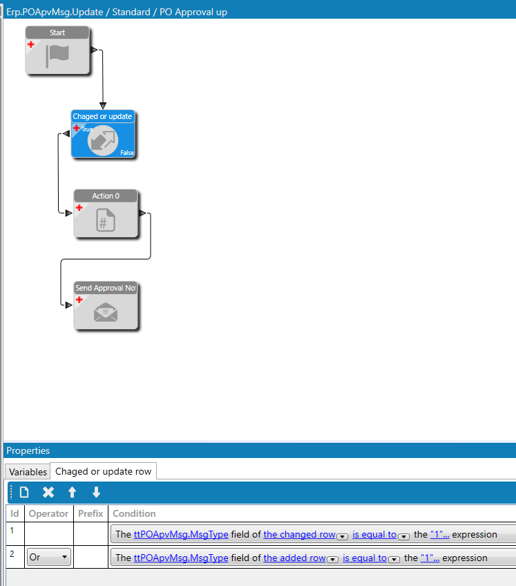

I have a data directive to POApvMsg table with condition on:
MsgType of the changed row is equal to 1 or msgtype con added row is equal to 1
if the condition is true, the following code is excecuted:
foreach (var row in ttPOApvMsg.Where(r => r.RowMod == “A” || r.RowMod == “U”))
    var agents = Db.PurAgent
    .Where(a => a.Company == row.Company)
    .ToList();
var approverAgent = agents.FirstOrDefault(a => a.BuyerID == row.MsgTo);
var buyerAgent    = agents.FirstOrDefault(a => a.BuyerID == row.MsgFrom);
if (approverAgent != null)
    callContextBpmData.Character01 = approverAgent.EMailAddress;
    callContextBpmData.Character04 = approverAgent.BuyerID;
if (buyerAgent != null)
    callContextBpmData.ShortChar02 = buyerAgent.EMailAddress;
var po = Db.POHeader.FirstOrDefault(p => p.Company == row.Company && p.PONum == row.PONum);
if (po == null) continue;
var vendor = Db.Vendor.FirstOrDefault(v => v.Company == row.Company && v.VendorNum == po.VendorNum);
if (vendor == null) continue;
callContextBpmData.Character02 = vendor.Name;
callContextBpmData.Character03 = po.EntryPerson;
this works perfect the first time, but since I have a multi level approval workflow that could be up to 4th level, only the first po approval notification is sent.
let’s say buyer1 has a po limite of 1500, his approver a po limite of 20,000. Next approver a limit of 60k and the last one has no limit.
so if buyer1 cuts out a po for more than 60k, the expectation is to have the data directive to send 3 emails… since there will be 3 approvals required, there will be cases in which 4 approvals will be needed.
with the code I have shared with you, just the first approver is receiving the notification.
BuyerID’s only have 2 authorized users, user and approver… all approvers have their own BuyerID with the same settings just 2 authorized users.
any suggestion will be very appreciated.

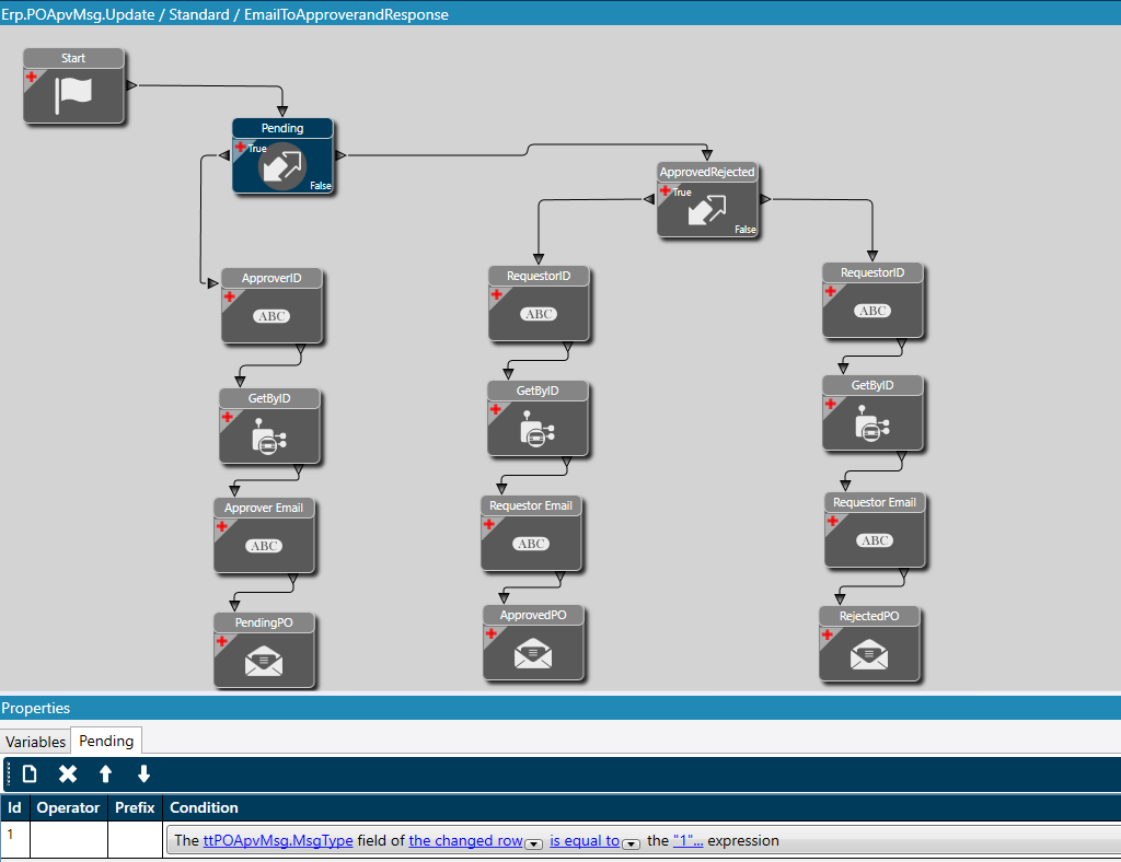

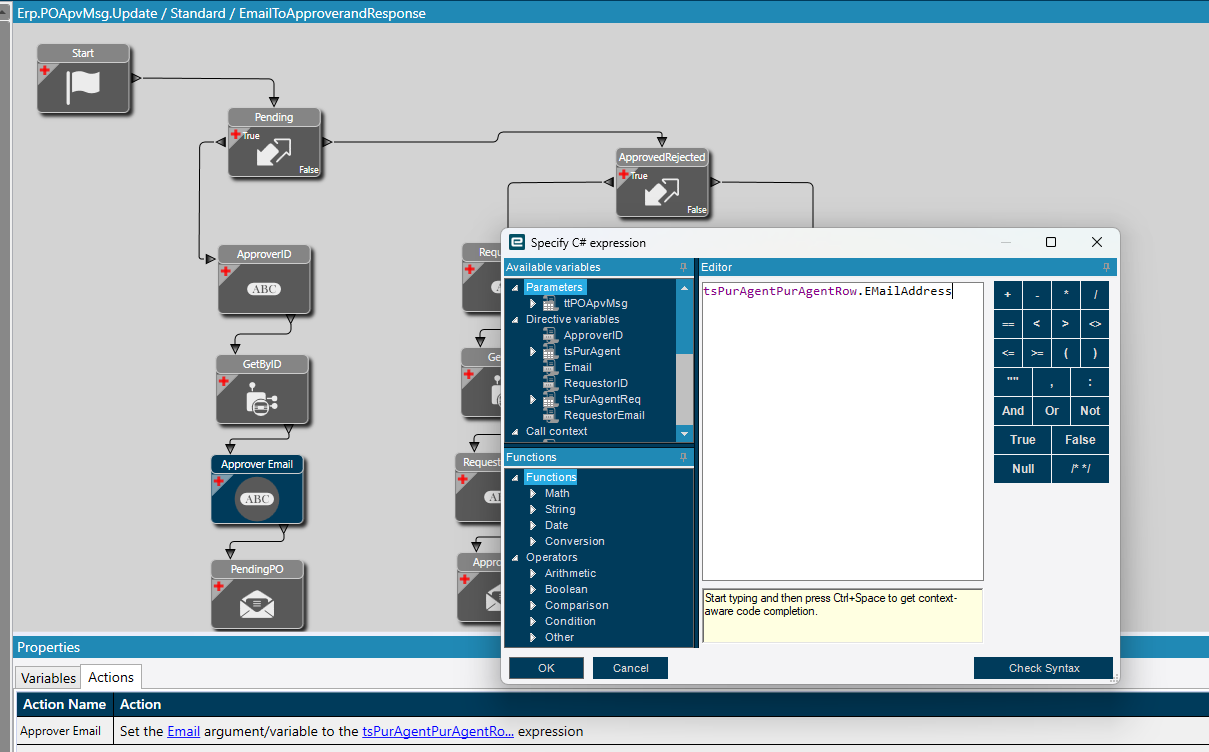

You want all emails to send at the same time? I have a widget based BPM that will fire off one email at a time until it hits the last appropriate approver in the hierarchy.
that is exactly what I’m trying to achieve.. one email every time an approval is required…
I’m no expert in C# but I’m pretty sure that code is only going to return the first level approver. I think the next step would be to look into recursion to traverse the entire approval hierarchy.
do you mind sharing your bpm design, maybe i can compare it with mine

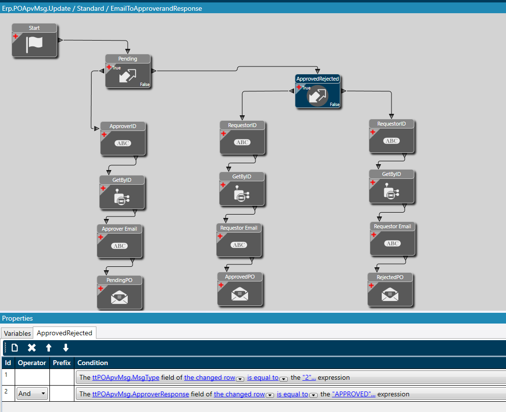

I do not have any type of recursion implemented, emails are sent one by one as the PO is approved up the chain. It works with the stock epicor approval logic but is slower than sending all mails at once. I also designed a dashboard to track what stage an approval is at.
Check for changed record

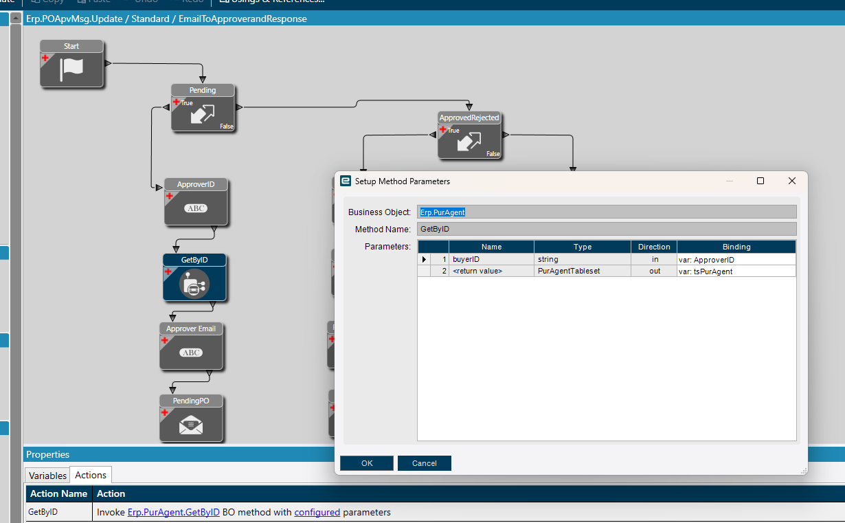

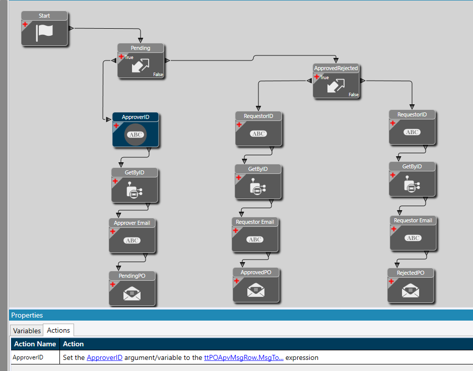

Get ApproverID

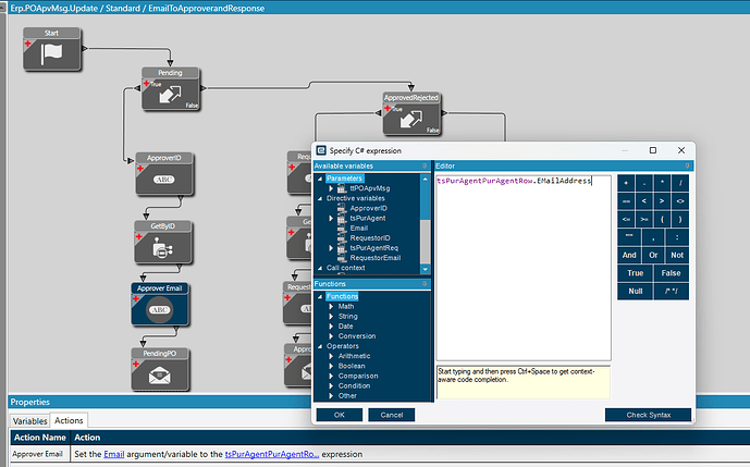

Look up approver details
Assign approver email to var
Send email back to buyer
