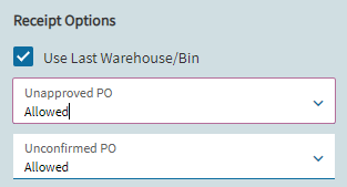

In our example user A raised the PO, above their buyer limit of £1k , PO was in ‘pending’ status but user A was able to receipt in the goods . So effectively over riding the system .
Check your settings in Company Configuration.
We are testing this out today John .
