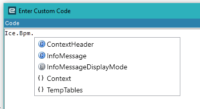

I am getting error - Ice.Bpm.Control.Controls - controls does not exisit
Regards,
Sudesh H Shetty
That property doesn’t exist (just like the error says) where did you get that code from?

Yeah, you’ll have to ask your friend then.
Is this code which is shared is totally wrong or only which I am getting error when execute
I don’t know of anything in a BPM other that a BPM data form that can present buttons and take a user input back. Which is really why I went to see if it existed, because it would be super helpful if it was.
So as far as my knowledge goes, this code is “Totally wrong”.
Although it’s possible that there is something that exists that I don’t know about.

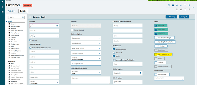

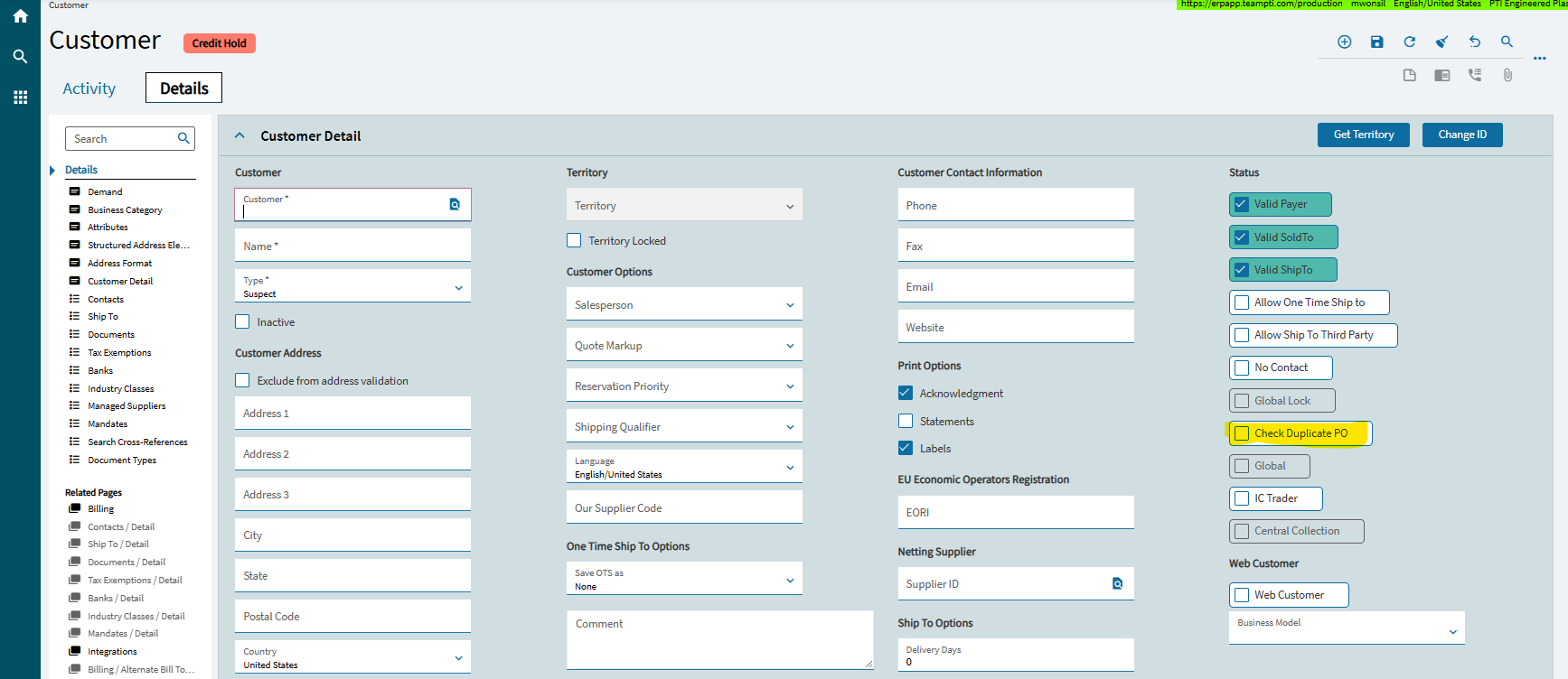

If you ALWAYS want to prevent a duplication PO, you can set it by customer:

We always check but infrequently we do allow a duplicate PO because the customer changed the PO and we want a new sales order. Up to now, we toggle the flag, add the order, and then toggle it back. But if the frequency is high enough, we will probably want to do the same. You may also want to display the other order and the amount to help the user in determining if it is indeed a duplicate.
