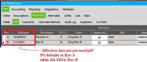

Our Purchase Order Entry screen defaults the latest part revision into the PO Detail line for Subcontract transactions. This is incorrect because when the Job number that is entered has its part number retrieved, the job’s revision number should also be retrieved but it is not.
I have tried selecting the Job’s part revision AFTER the latest part revision is defaulted but no matter what I try, it keeps the wrong part rev.

Wonder if your rev is approved…
and/or it’s effective date is either in the future/earlier than the other rev?
