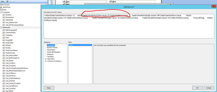

Hello All,
I am trying to understand how the partnum1 field works on the base po form. Can anyone tell me where the Fields.VendorPartOpts.Value is coming from???
Thanks in advance for any help.
Respectfully,
Utah

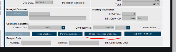

Thanks for tracing it or however you found it @hkeric.wci ! There is a supplier price list set up, but I don’t know where the cross ref options dialog is… In other words, I don’t know what options cause this field to be set differently in the Po Suggestion process. I would think it would run when putting in a new part on PO detail as well… Would have to trace it to find out.
Part Cross Reference Options (Purchase Order Entry > Lines > Detail > Part Cross Reference Options)
Use the Part Cross Reference Options dialog to specify part cross reference printing options for supplier, manufacturer or substitute parts selected for the purchase order line. This determines the level of part cross-reference detail that should print on supplier-facing documents such as the purchase order form.
Mfg / Manufacturer Part
Specifies how qualified manufacturer’s part numbers should print on supplier-facing documents such as the purchase order form. This field is unavailable if no qualified manufacturer’s part numbers have been selected for the internal part number being ordered on this purchase order line. Select one of the following options:
  • Print Manufacturer’s Part only - Prints only the qualified manufacturer’s part number that is selected for a purchase order line prints on supplier-facing documents.
  • Print all Manufacturer Parts - Prints all qualified manufacturer’s part numbers associated with your internal part number on supplier-facing documents.
  • Not printed - Skips printing of the qualified manufacturer’s part number on supplier-facing documents.
Substitute Part
Specifies how substitute part numbers should display in Purchase Order Entry, and print on supplier-facing documents such as the purchase order form. This field is unavailable if no substitute part number have been selected for the internal part number being ordered on this purchase order line.Select one of the following options:
  • Print as a cross reference. - Prints the selected substitute part number as a cross-reference on supplier-facing documents. The substitute part number displays in the Cross Referenced Part field in the Purchase Order Entry - Lines Detail sheet. Your original internal part number displays in the Part/Rev field.
  • Original part not printed - Prints only the substitute part number, and skips printing of the original part number on supplier-facing documents. This is the default value for this field.
  • Print original as a cross reference. - Prints the original part number as a cross-reference on supplier-facing documents. The original part number in the Cross Referenced Part field in the Purchase Order Entry - Lines Detail sheet, and the substitute part number displays in the Part/Rev field.
Supplier Part
Specifies how supplier part numbers should print on supplier-facing documents such as the purchase order form. This field is unavailable if no supplier part numbers have been selected for the internal part number being ordered on this purchase order line. Select one of the following options:
  • Print as a Secondary Reference - Prints the supplier part number selected on the purchase order line as a secondary reference (along with your internal part number) on supplier-facing documents.
  • Print as main part reference - Prints the supplier part number as the main reference, along with your internal part number, on supplier-facing documents. This is the default value for this field.
  • Print only the Supplier Part - Prints only the supplier part number selected on the purchase order line on supplier-facing documents, and skips printing of your internal part number.
  • Print all Supplier Parts - Prints all supplier part numbers associated with your internal part number on supplier-facing documents.
  • Not printed - Skips printing of the supplier part number on supplier-facing documents.
