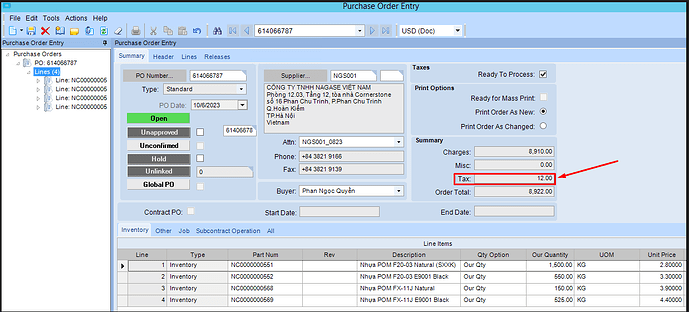

Please help me with this case:
I create PO from Req: with Currenry VND, no taxes.

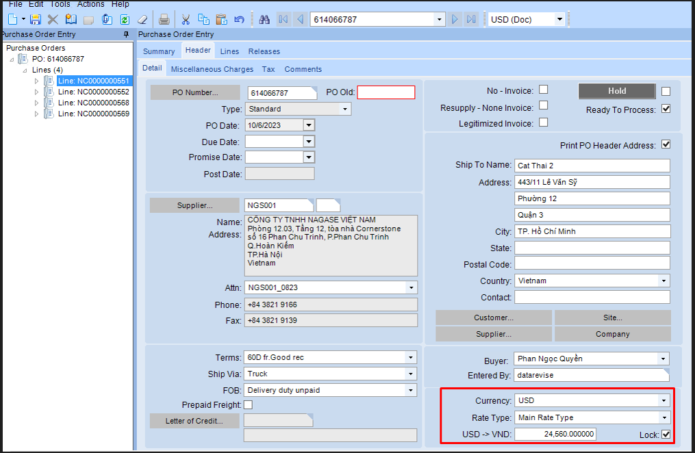

Then, I changed Currency to USD with a lock rate. And I changed the price of 4 lines.

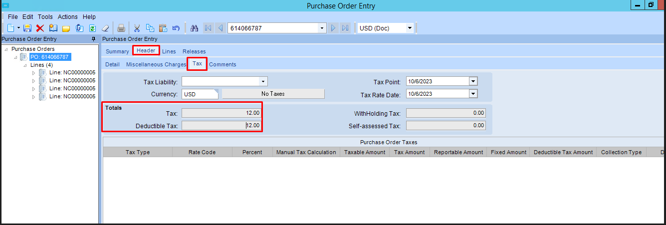

When saving, PO without taxes, it increases upto 3. What is the cause here, how to solve this?
I tried to create new taxes and deleted it, but it continues to increase upto 12.

Check if supplier has any tax liability attached, if so remove it
