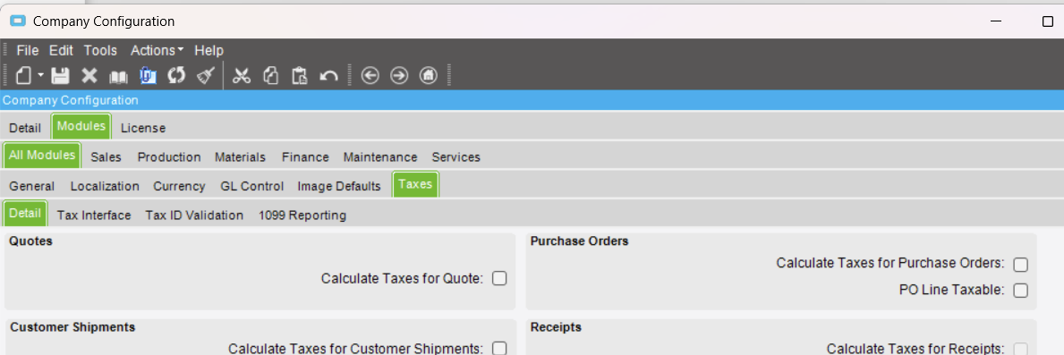

Unfortunately, I believe it works but it does not turn off the Taxable flag. That is really my end goal, to have the Taxable flag be false. Looks like it is a BPM.
It’s in Company Config, under All Modules, Taxes, Detail:
On the right-hand side.
FFS!!
Thank you.
