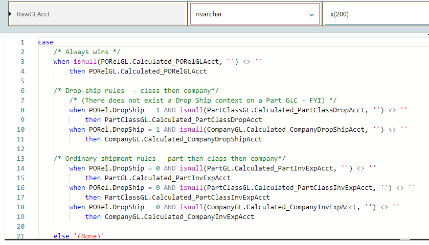

I just made a massive BAQ a couple weeks ago for accounting so they could know what account went with each release.
A snip of part of the logic I had to do:
