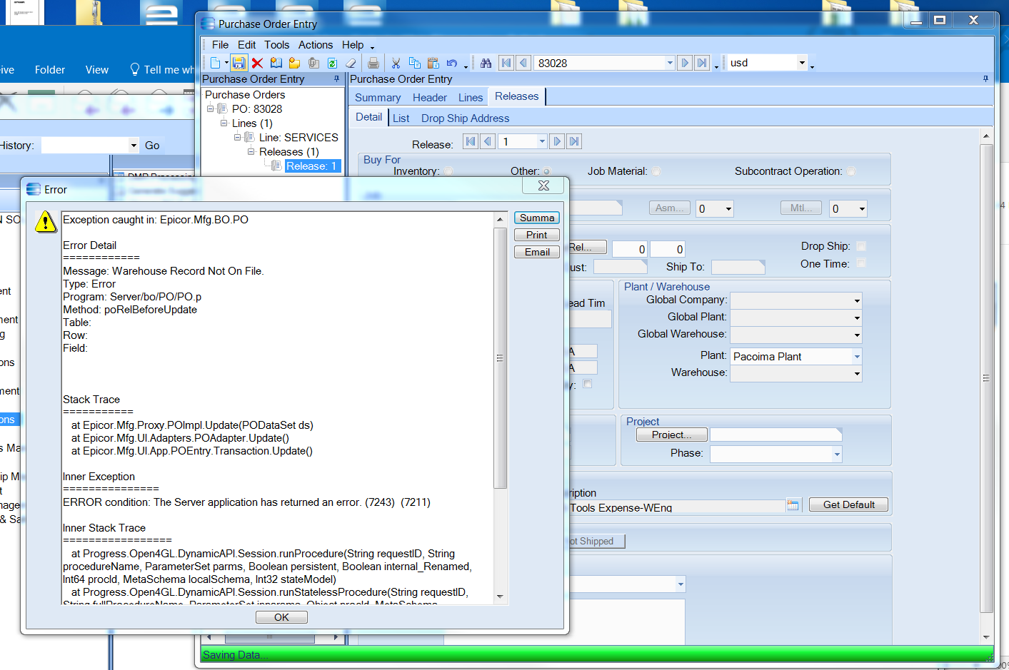

When I try to change the Plant on the PO Release I get an error message. Odd, Part is set up in both plants.
In E10, I can’t ever change the Warehouse on a PO Release. The field is never available, even when I have multiple warehouses setup.

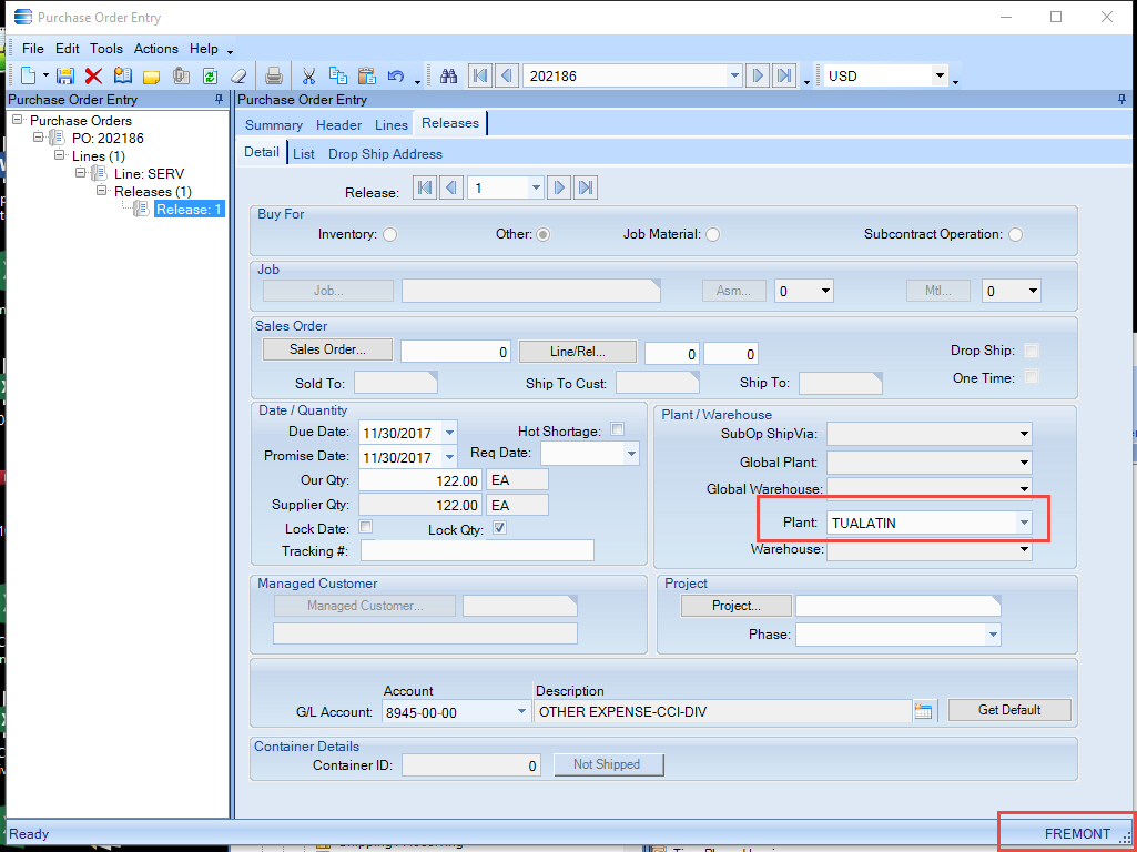

I just created a PO as Other in Fremont Plant and was able to change to TUALATIN Plant.

That is what I told the user to do…at least it was a work around. But I even created a new PO for testing and still couldn’t change it with out getting that warehouse error.
I even tired it with the BASE form and get the same message.

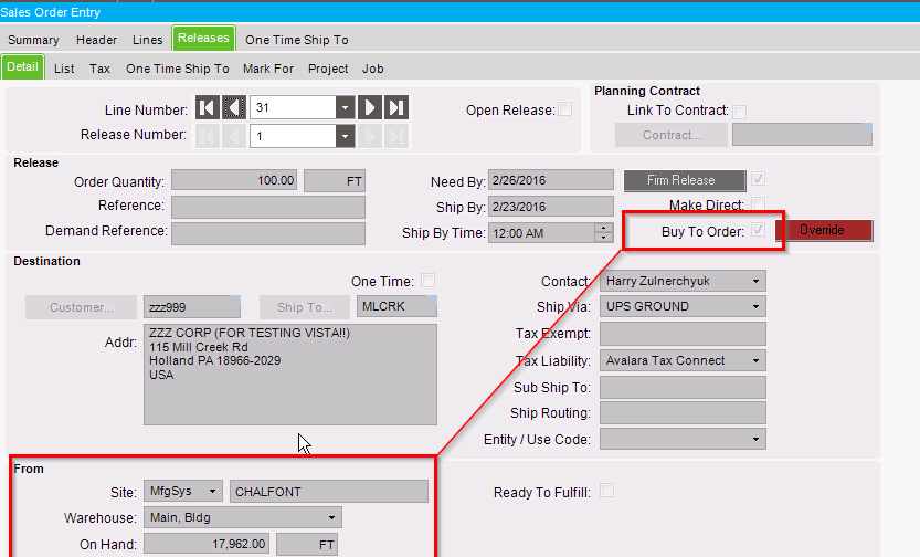

Event though the PO entry screen shows as “Buy To Other”, is it actually a “Buy To Order” (which displays in the PO entry as Buy To Other)? I would anticipate problems if the source of the order line release is another plant.
If it is Buy To Order, Check the “From” on the Order Release
