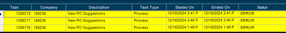

We are experiencing trouble exporting the “PO Suggestions” to Excel. The notification that appears in the top-right corner indicates that the export was successful. However, when I try to open it through the notification panel, it does not load. The System Monitor displays the following image:

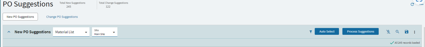

“A column named ‘DynAttrValueSetShortDescription’ already belongs to this DataTable.” Additionally, when I open the PO suggestion screen, no records are displayed.

I’ve been getting this error since the upgrade to 2025.2 yesterday. The suggestions load in the grid but when I export them to Excel, I have the same error as you but on a different column (And another user also had a different column)
