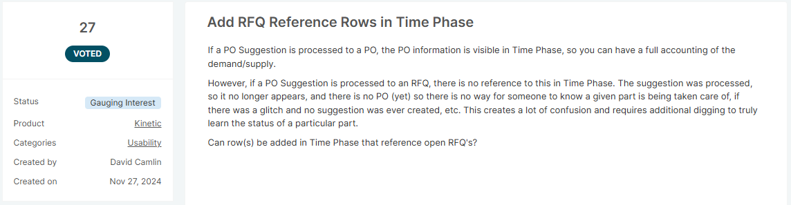

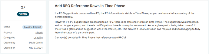

Deep end of the pool, one “gotcha” that we’ve experienced is, if there is an open RFQ for the part… you won’t get any new suggestions.
So, if this part had a suggestion at some point and Buyer converted that to an RFQ, Epicor won’t generate any additional suggestions. It will wait for the RFQ to be completed with a response.
I put in an “Idea” for that a year and a half ago… but… crickets:
