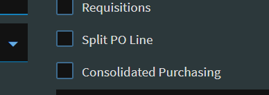

If anyone needs an update, one way to accomplish this is to have the part class checks “Split PO Line”
This makes it that different PO lines are created for each PO suggestions that has a different comment.
In our case we set the comment to the price when clicking the “Buy” button in suggestions, and ignore this comment in the reports.
