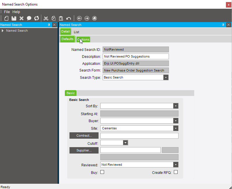

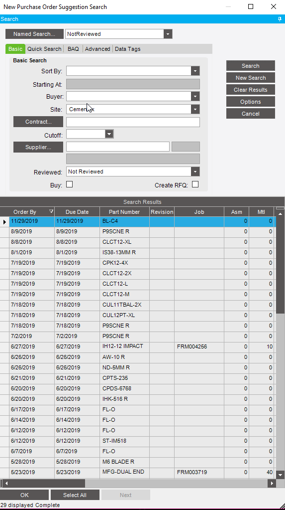

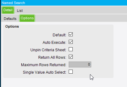

We run PO Suggestions daily at 4:30a as a net change. We have the new PO Suggestion module set as a named search that auto populates when we run it to show only those POs which have been set as Not Reviewed.
Every single day when we run this, even though POs are marked as Reviewed, these still all appear again. Are we missing something?
What do your named search settings look like?
Have you run a query and made sure there are suggestion records marked as reviewed? Running net change shouldn’t be clearing the checkbox when suggestions run.
Yes, we have reviewed them and know that these were marked as reviewed and yet they are reappearing.
Reread your message. I queried to see if any were marked as reviewed. Low and behold they are not.
If you mark them as reviewed today, do they not stay marked as reviewed tomorrow? This is very frustrating from my buyer’s perspective.
