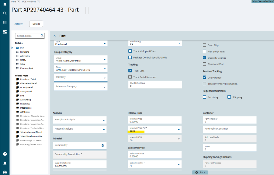

Also noticed this weirdness on an affected part. Not sure it that’s a DMT anomaly or just a display issue on the combo. The client didn’t want to pursue further at this time so we have clues but no answers.
