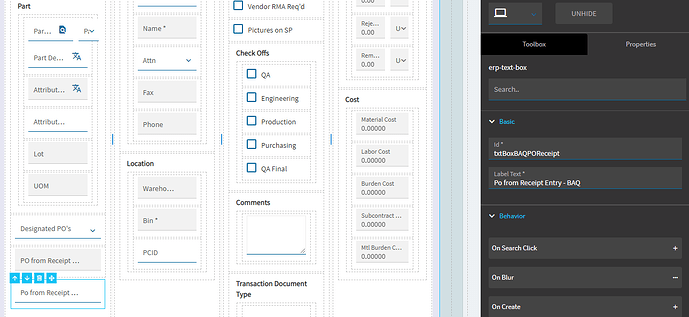

Populate a text box with a BAQ

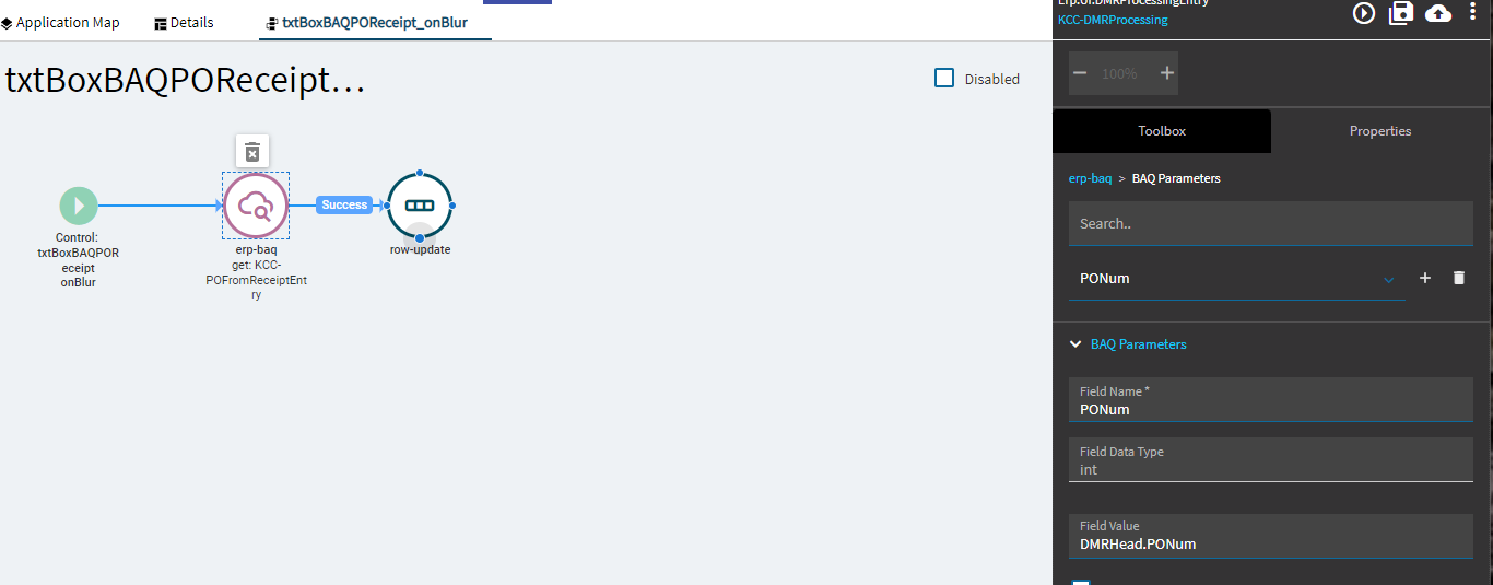

On the DMR Processing page I’ve added a read only text box. I have a BAQ has a PONum parameter that I want to pass the DMRHead.PONum too and have the text box populate with the BAQ data.
The baq works when you pass in a PONum. But it’s not populating my text box. Any help would be much appreciated.

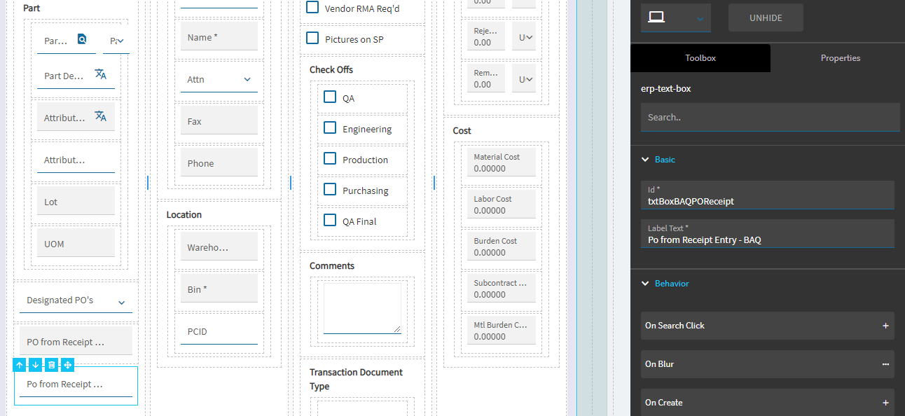

I set up an unblur event on the text box.

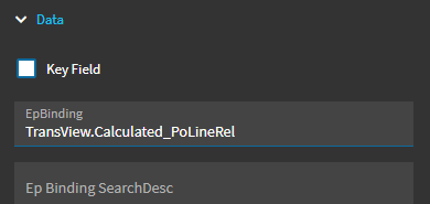

and I’m binding it to the calculated field in my baq.

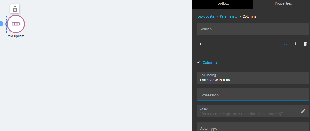

You bound your textbox to TransView.Calculated_PoLineRel
… but your row-updating TransView.POLine
Shouldn’t those be the same binding? I’m not sure I’m following correctly. Are you populating a dataview with the BAQ results?
