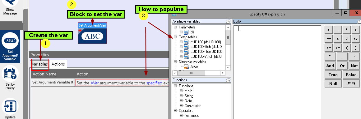

Hmm…I get that you don’t want custom programming, but I think this would be way easier if you did allow at least the setting of a variable by a c# expression using the Set Argument/Variable widget.
and I haven’t been fully caffeinated this morning yet either, so bear with me, but I also assume you know how to create local variables within the BPM? That would give you a place to store your data and then parse out to set your field

I have created a variable ShipToTerr.
I attempted to use the SetArgument/Variable as follows:
Set the ShipToTerr argument/variable to the specified expression.
My expression (based on your example) is this:
(char?)(from row in Db.ShipTo where row.Company == callContextClient.CurrentCompany && row.CustNum == custNum && row.ShipToNum == ShipToNum select row.TerritoryID).FirstOrDefault() ?? 0

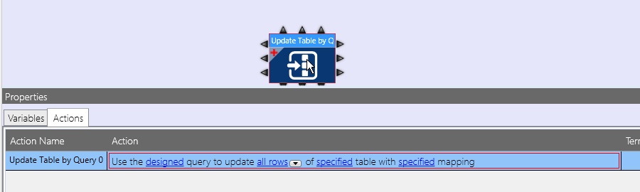

If I can use a query to populate the variable, that would be ideal. I had not gone down the Update Table by Query route because I don’t want to update a table; I wanted to populate a variable. Unless the variable table (is there such a thing?) is what I would be updating?
You said the end goal was to set the Sales Rep. That’s the thing in the table you need to update (based on the logic you described)

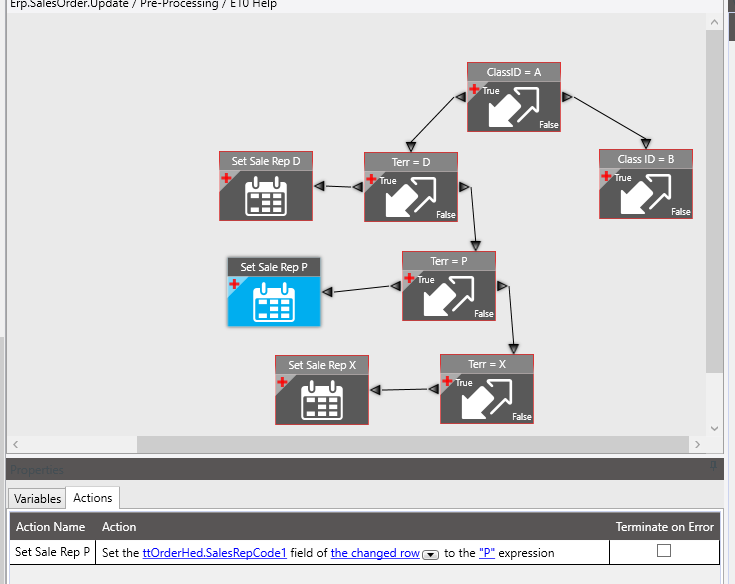

If you want to avoid code altogether, you can do it with a bunch of condition widgets.
Here’s a partial example.
EDIT
Lots of steps not shown. I was just trying to illustrate the use of Condition widgets
