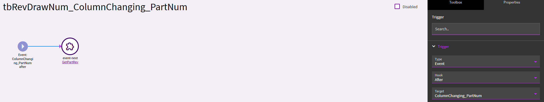

  1. If you’re already on a Line Item record and the user changes the PartNum

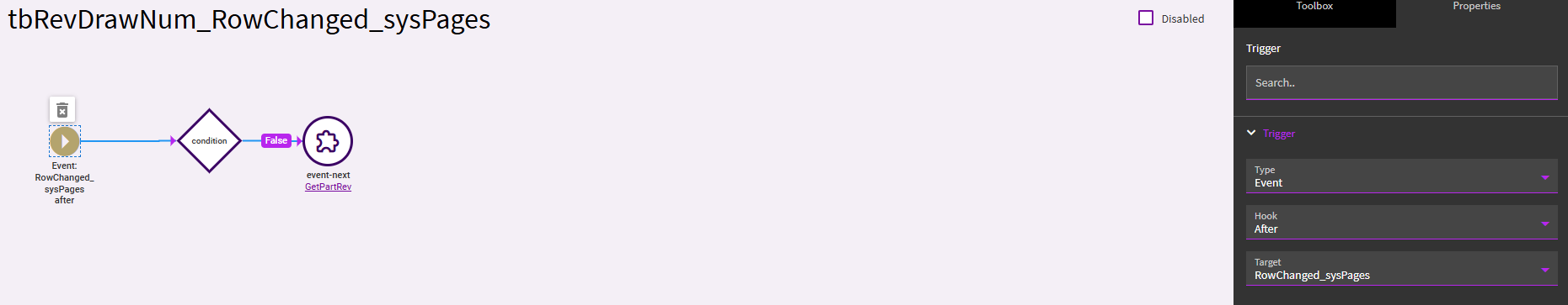

  2. Any time the RowChanged_sysPages event runs… if the PartNum is defined run my event
Condition: "{PODetail.PartNum}"==="undefined"

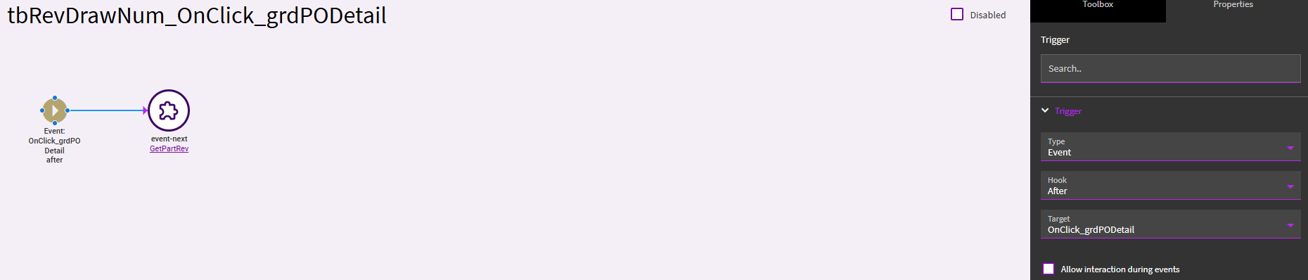

  1. If the user clicks a Line Item number in the POHeader form (Line Grid)… it navigates to the PODetail form… I need my event to run. So, I trigger this one after the native event:

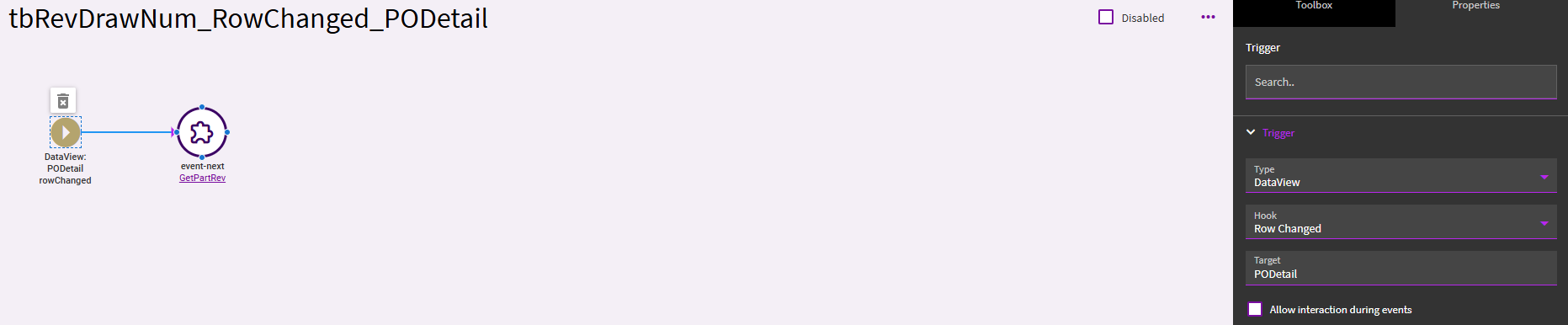

  2. If you’re on the PODetail page and use the top navigation to go to a different line… run my event:
