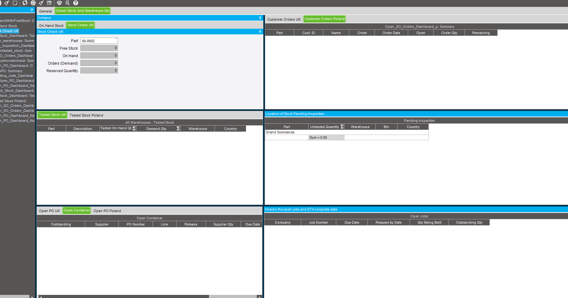

Hello this may sound stupid but a while back I created a new part tracker for our company please see bellow I did this through dasboard and positioned it accordingly and all of them snapped into place however when trying to make a new dashboard my BAQ’s just hover over each other and dont snap next to each other. I have drawn a red box I essentially want them side by side
The panes are finicky, but you should be able to drag the second query to the right side of the main window until you see a faint outline marking where it will end up. It may take some trial and error to figure out where exactly along the side of the screen you need to position it, but once you get it, it will snap into place where you want it.
