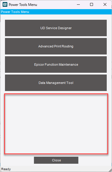

I was able to install the Power Tools client but didn’t see a way to change the company. I had to close it down, log into Kinetic pilot, change companies, then log into the Power Tools client again. Anyone else seeing another way to change companies or set a default company?
Check the .sysconfig maybe.
Not tried it and not at a pc to test. However is it like classic MES where you right click on any spare space with change company in the context menu?
Ope - it is! Right click in this area:
