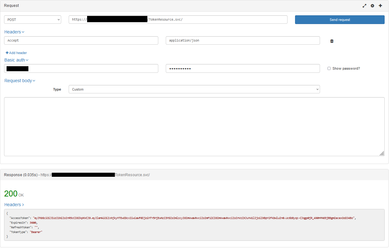

Not a big fan of the black box $cred thingie (or of powershell for that matter)… Try just adding the header Authorization: Basic (user:pass encoded to Base64), no -Credential switch…

Progress! I navigated a few other errors and have landed here now. I know I have seen this before but forget what caused it. The token is creating successfully I have it printing to my screen before this code is run.
