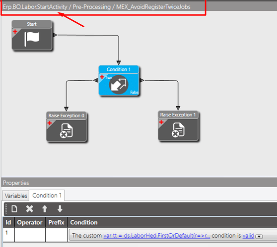

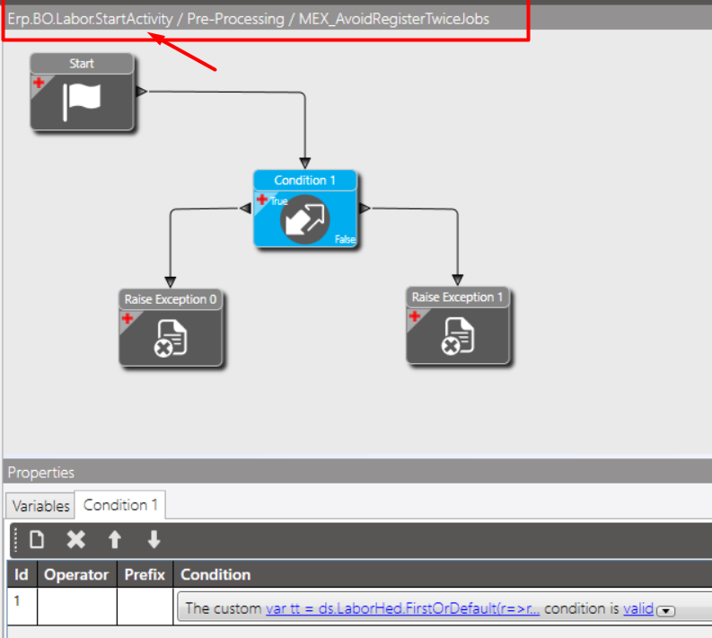

I am trying to prevent a user from being able to register for multiple jobs simultaneously in the MES.
Code
var tt = ds.LaborHed.FirstOrDefault(r=>r.Added());
bool flag = false;
if( tt != null )
  string empID = tt.EmployeeNum;
  var activeLabor = (from lh in Db.LaborHed
                       where lh.EmployeeNum == empID && lh.ActiveTrans == true
                       select lh).FirstOrDefault();
  if (activeLabor != null)
     throw new Ice.Common.BusinessObjectException("You already have an active job. Finish the current job before starting a new one.");
     flag = true;
else
    // Lanzar un error si no se encontrĂł ningĂşn registro
    throw new Ice.Common.BusinessObjectException("No record of work activity was found.");
return flag;
Can someone tell me why it doesn’t throw the exception when we start production?

The empID comes with a name (Louis.Martinez), when it should be a Number (52358).
For example:
