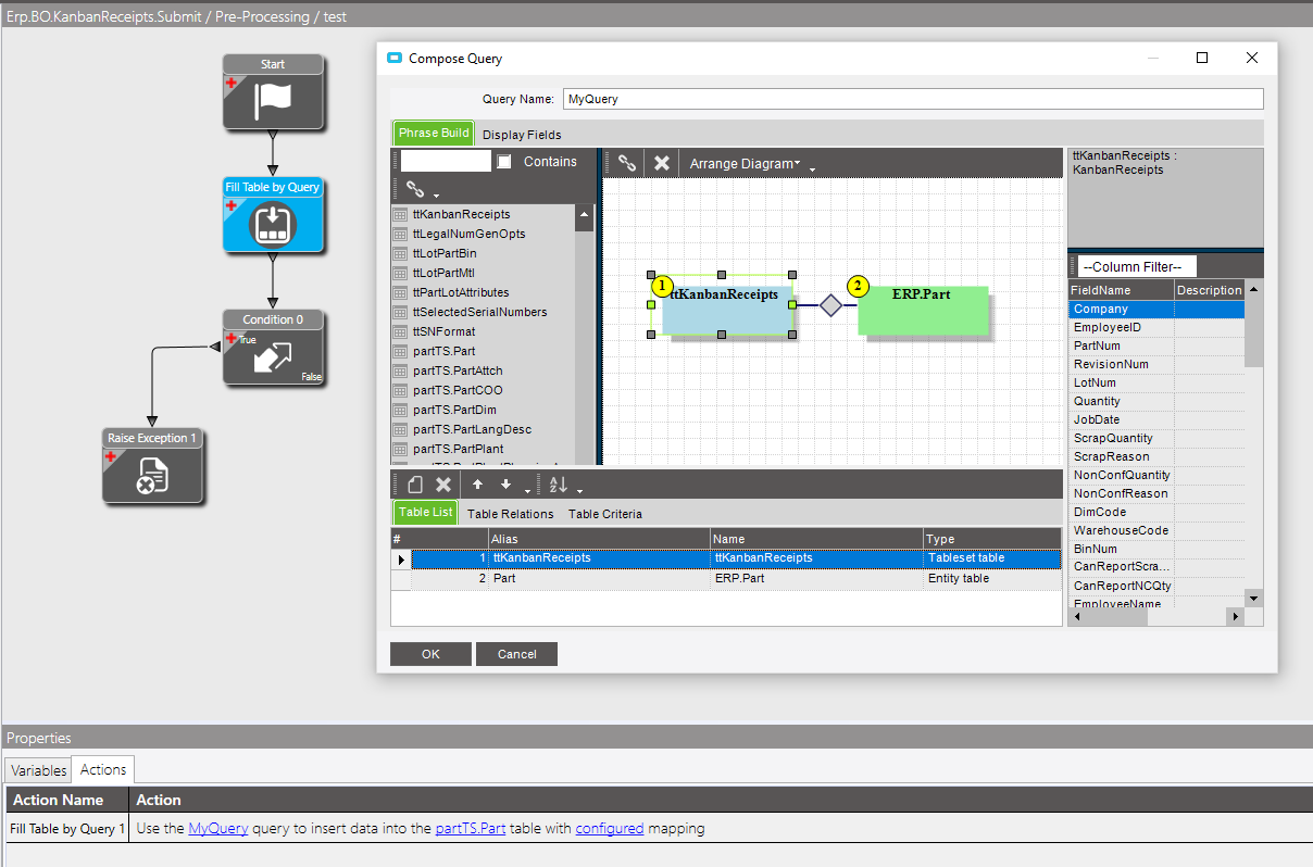

But maybe you could get the part.PhantomBOM field using a fill table by query.
Just link the current ttKanbanReceipt row to the part table by company and part.
Then use the results of that query to check and stop the submition of that kanban receipt if PhantomBOM is true.

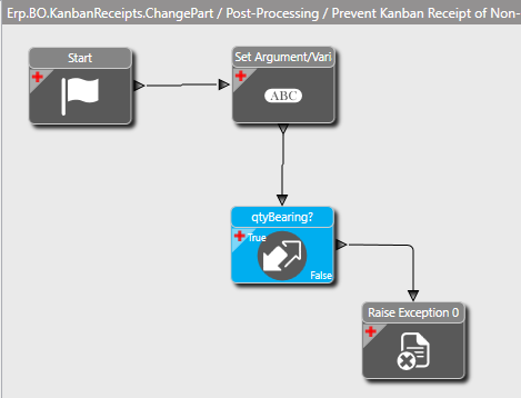

@WayneH - I would do a trace and evaluate what the method that fires when you enter or change the part number in the Kanban receipts screen. When I did it, I am getting KanbanReceipts.ChangePart. I would make a post-processing on that method… Then I’d create a boolean variable in your BPM context called qtyBearing. I would then set the variable using the widget and I’d write a LINQ query such as this (corrected):
(from p in Db.Part
where p.Company == @CompanyID
&& p.PartNum == dsKanbanReceiptsRow.PartNum
select p.QtyBearing).FirstOrDefault()
Now that you’ve stored your qtyBearing variable for the given part, you can use it in a condition widget and you’d select the condition type “The specified argument/variable is equal to the true expression.”
Then I’d use a Raise Exception widget off the false side of the condition widget to display a message to the user explaining that you can’t use Kanban Receipts for parts that are not qty-bearing.
Some other thoughts:
I used qty bearing instead of phantom because all phantoms are non-qty-bearing but you also wouldn’t want to receive a non-qty-bearing anything… But you could easily pick the PhantomBOM field instead and that would be fine (you’d want to switch the side of the condition widget you hang the exception on, though).
You can also use the current plant session variable and filter to that in your PartPlant (instead of Part) table and check the QtyBearing or PhantomBOM fields there. Those are able to be set by site so if you’re running multi-site, I’d look at the PartPlant table instead of the Part table.

That’s my bad. I don’t think I copied/pasted all the code. Sorry about that.
it should look like this:
(from p in Db.Part
I’ve corrected it above also just in case someone else tries to copy/paste that they won’t have to read through additional comments to find the correct syntax.

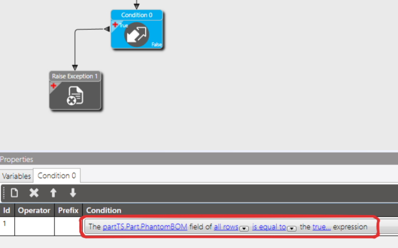

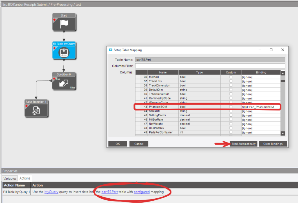

I’d go with Dan’s approach, but fyi…

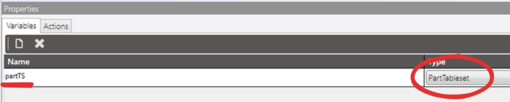

To use the “fill table by query”, the query has to put the data somewhere, so I made a variable (partTS) of type “PartTableset”.
Then I mapped the query results into the variable, which contains a Part table. I always use Bind Automatically cause it auto-maps the fields you’ve include in your query.
After that you should be able to check the value from your variable.
Excellent, that worked -
