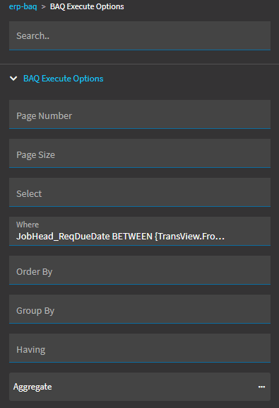

Thank you for the suggestion David! This works great. Now I’m trying to implement the same filters as before (using the WHERE List clauses I had set up for the previous ‘BAQ Grid’). Now that I’m populating the DataView/grid separately using rest-erp, being limited to the single “Where” textbox in BAQ Execute Options is becoming tricky.
I have 2 date picker controls to filter the grid by JobHead_ReqDueDate. The clause I’m currently using is JobHead_ReqDueDate BETWEEN {TransView.FromDate} AND {TransView.ToDate}.

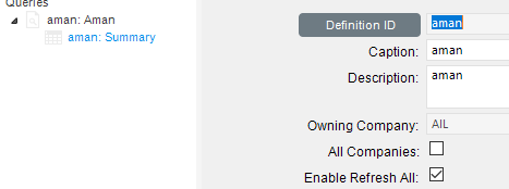

Steps to Follow:
  1. Open the dashboard.
  2. Select your deployed dashboard.
  3. Locate the required BAQ Query.
  4. Right-click on the BAQ Query and select Properties.
  5. Enable the Auto Refresh on Load checkbox.

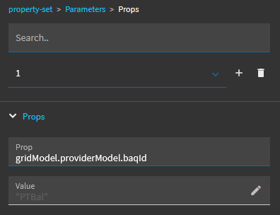

An alternative solution I’ve tried and have (somewhat) working is manually setting the ‘Baq ID’ on the Provider Model of the grid within my event using property-set. This allows me to use the Where List (rather than being forced to a single Where Clause) making it much easier to uplift Classic dashboards that have multiple filter controls for a single BAQ Grid. The only issue I’m having is the empty Panel Card Grid must be closed and re-opened for the actual data to appear on screen. After being re-opened, everything works as intended.
My property-set widget:

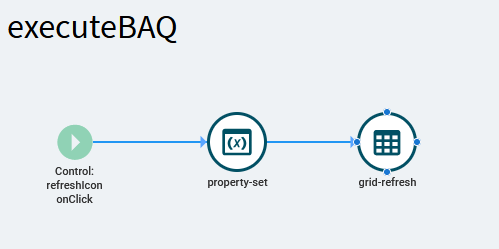

I thought throwing a simple grid-refresh following the property-set in my event would do the trick-- nope. The only action I’ve taken to get the grid to display the BAQ query data is to manually close and re-open the panel.
My event structure:
Both actions run successfully when the event fires:
events-running

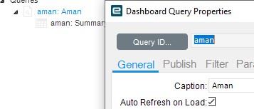

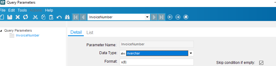

  6. Also check in baq parameters skip condition is empty
:wink:
This is a Kinetic dashboard, not a classic one.
