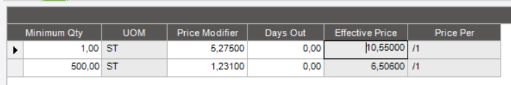

Hey everyone, I’m running into something I know little about, we have 2 different locations (Company’s) within our Epicor, and with one company the Effective price is the Price modifier. With the other one it isn’t. does anyone know what affects effective price? and how I can change it so that it is equel to the effective price?
The screenshot is from a pricelist

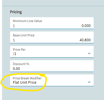

In your Pricelist set up, there is a control for what to do with your “Price Break Modifier”… and you have (2) options. Either a “Flat Unit Price”, or a “Percent of Base”.
Assuming your base unit price is 5.275 and your Price Break Modifier is set to “Flat Unit Price”. So this is just going to ADD the Modifier to you Base Price:
Price + Modifier = Effective Price
5.275 + 5.275 = 10.55
5.275 + 1.231 = 6.506
Usually, for price breaks, a qty of (1)… you would just have a modifier of (0).
I would also expect if you buy a qty of (500), your price should go DOWN. So, the modifier there should be a negative. That would give you:
5.275 + 0 = 5.275
5.275 + (-1.231) = 4.044
