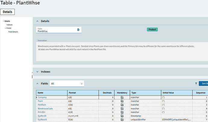

Hi All,
For the life of me I canot find what table the primbin field is in for Part-Sites-Warehouse-Primary Bin.
I’ve looked in Partwhse, partbin, partbininfo, partplant, and more, could please tell me where it is?

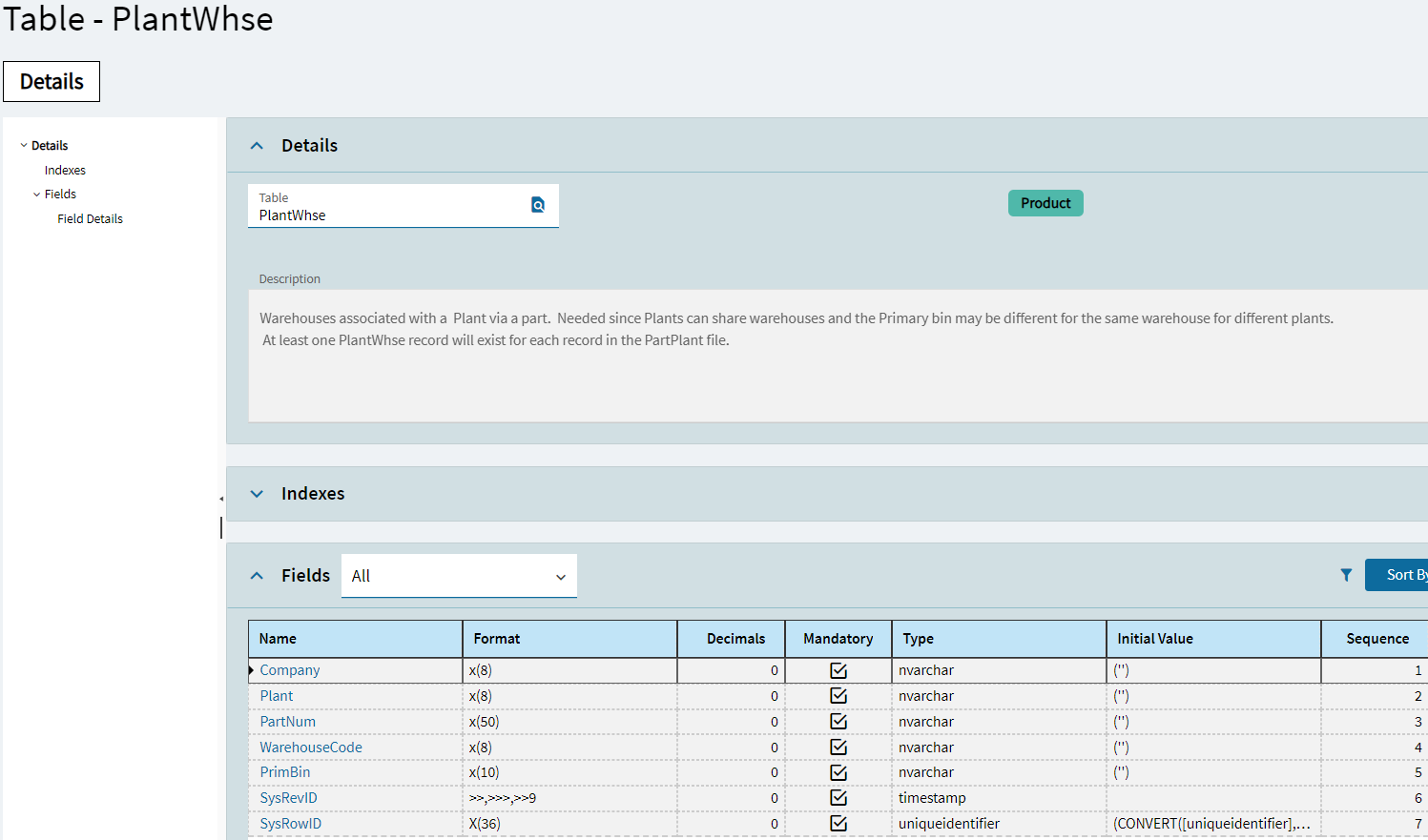

Hi All,
Try PlantWhse.
Yes, field help was telling me it was under partwhse…
Probably was/is in a previous version - maybe before they added multisite/plant support?
DataViews in Application Studio have a tendency to pull stuff in from many tables and then calculate fields that sometimes seem like they would exist somewhere like partbin, but they do not. I have this problem sometimes myself.
