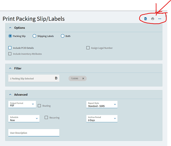

I have a user when tires to print the printer icon is grayed out on the slide out. I have even logged in on their computer and I have the same issue.
I have checked that local printers are installed an working (can print from other places)

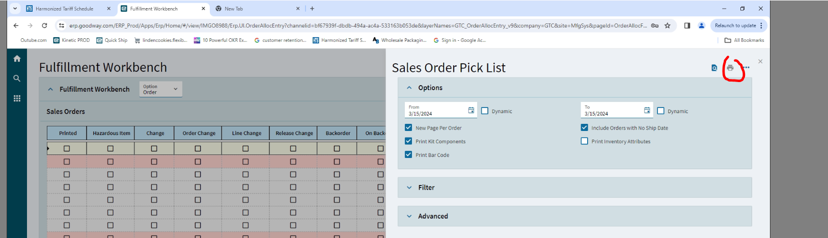

Anything we try to print. He is trying to print a SO Pick List and I also tried an Order.

Even going directly to SO Pick List I get the same issue.

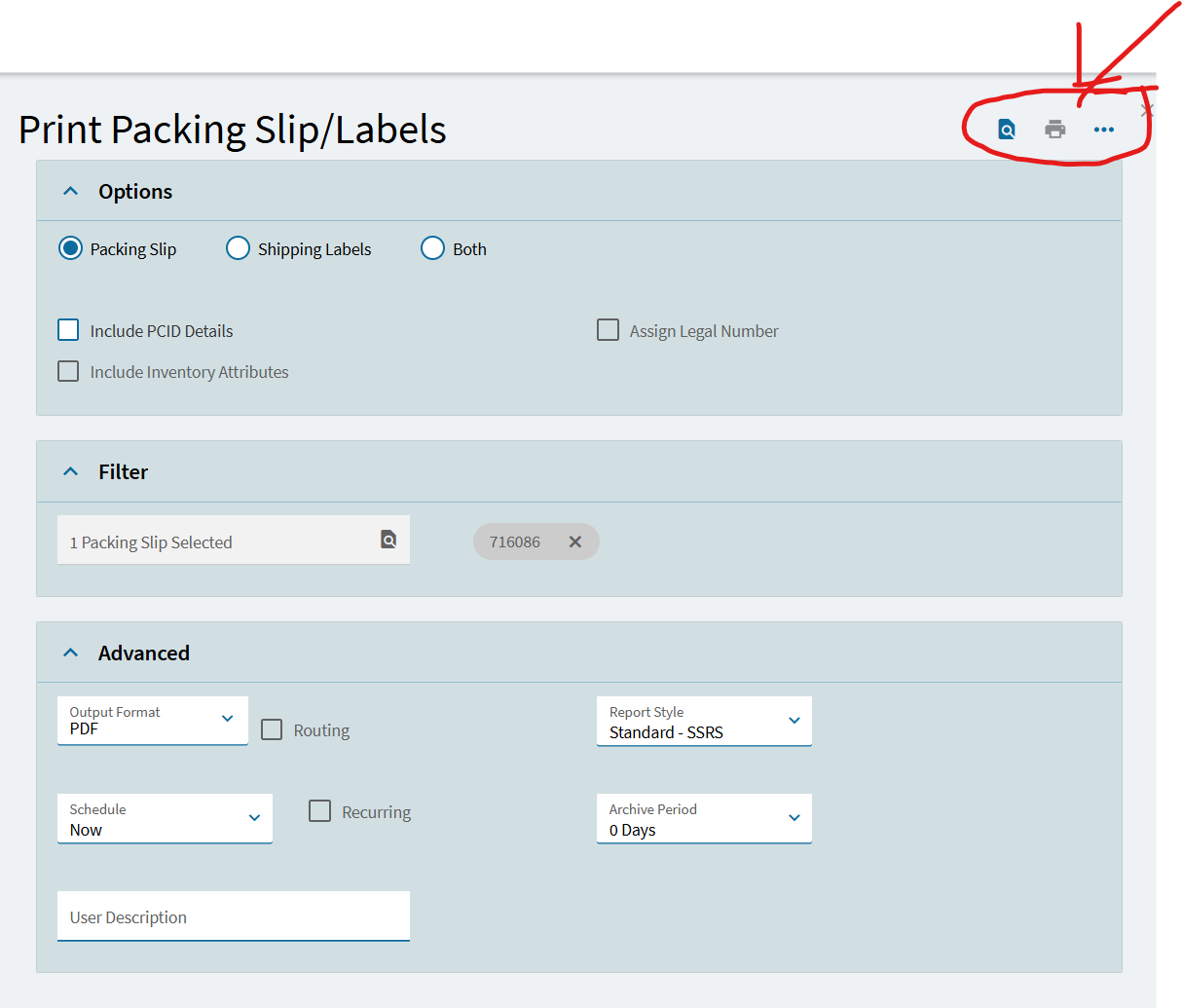

Were you ever able to get this figured out? We have the same issue. Printer Icon one print forms is grayed out. Currently working with Pack Slips and Order but have tested on many other screens. We have tested on many machines and users.

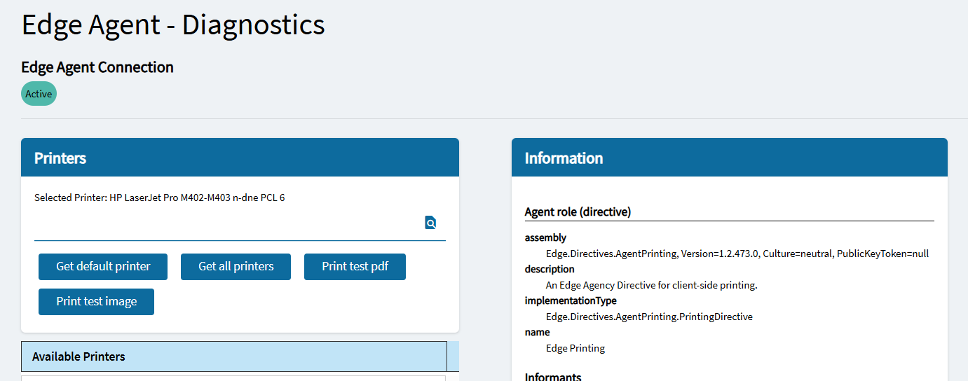

Have you tried Edge Agent Diagnostics? Find the Agent icon in the system tray, right click, select Diagnostics…

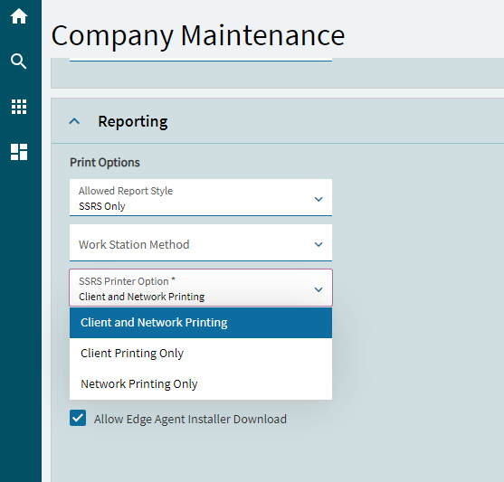

EDIT - also found this - check Company Maintenance
