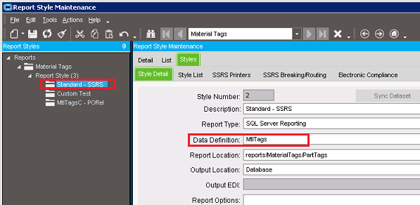

If so, wondering what data definition(s) are specified in your “MtlTag” report styles?
i.e. is the default report style NOT specifying the Data Definition MtlTags?
Reason I ask, I’ve had to rebuilt custom RDD’s after past upgrades due to similar issues you describe.

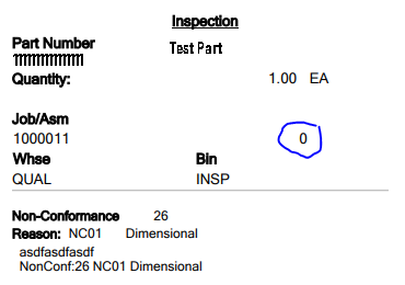

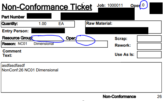

I have only recently been informed of the problem. It could have been as early as our upgrade to 10.2.600 but unsure. I will look into MTL Tags and see what it is using in the data def.
Yes, I believe the same Report Style (“MtlTags”) is called from both.
So if the default style is “Standard SSRS” and its Data Definition is “MtlTags” then may want to contact Epicor directly.
I’d only try fixing myself if some other style were defaulting, or the standard style uses a data def other than MtlTags.
