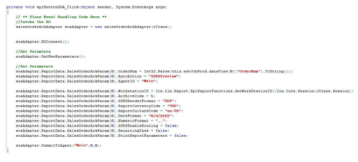

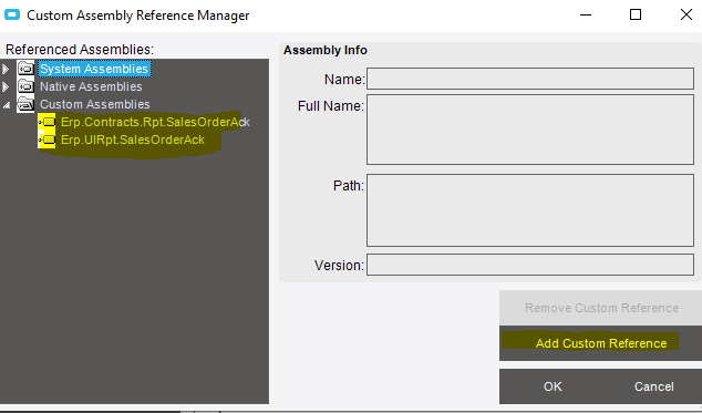

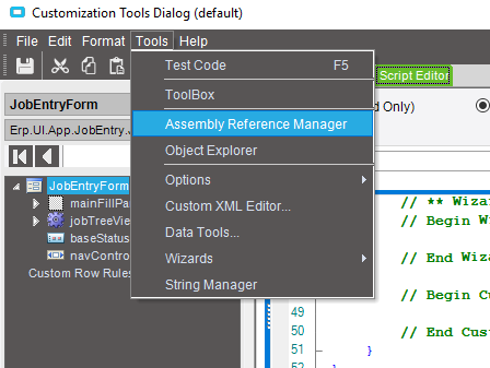

You can also use the salesOrderAckAdapter and pull the order number off the JobProd data view. Seems like most boxed reports have an adapter that works the same way, I tweaked some code I had for the JobTravAdapter. I used the wizards to create a button click event and EpiDataView reference, then referenced Erp.Contracts.Rpt.SalesOrderAck , Erp.UIRpt.SalesOrderAck , and Ice.Core.Session via the custom assembly reference manager.
    		this.edvJobProd = ((EpiDataView)(this.oTrans.EpiDataViews["JobProd"]));
    		this.edvJobProd.EpiViewNotification += new EpiViewNotification(this.edvJobProd_EpiViewNotification);
    		this.epiButtonSOA.Click += new System.EventHandler(this.epiButtonSOA_Click);
private void epiButtonSOA_Click(object sender, System.EventArgs args)
		//Invoke the BO
		salesOrderAckAdapter soaAdapter = new salesOrderAckAdapter(oTrans);
		soaAdapter.BOConnect();
		//Get Paramters
		soaAdapter.GetNewParameters();
		//Set Parameters
		soaAdapter.ReportData.SalesOrderAckParam[0].OrderNum = Int32.Parse(this.edvJobProd.dataView[0]["OrderNum"].ToString());
		soaAdapter.ReportData.SalesOrderAckParam[0].AutoAction = "SSRSPreview";
		soaAdapter.ReportData.SalesOrderAckParam[0].AgentID = "Main";
		soaAdapter.ReportData.SalesOrderAckParam[0].WorkstationID = Ice.Lib.Report.EpiReportFunctions.GetWorkStationID((Ice.Core.Session)oTrans.Session);
		soaAdapter.ReportData.SalesOrderAckParam[0].ArchiveCode = 1;
		soaAdapter.ReportData.SalesOrderAckParam[0].SSRSRenderFormat = "PDF";
		soaAdapter.ReportData.SalesOrderAckParam[0].ReportCurrencyCode = "USD";
		soaAdapter.ReportData.SalesOrderAckParam[0].ReportCultureCode = "en-US";
		soaAdapter.ReportData.SalesOrderAckParam[0].DateFormat = "m/d/yyyy";
		soaAdapter.ReportData.SalesOrderAckParam[0].NumericFormat = ",.";
		soaAdapter.ReportData.SalesOrderAckParam[0].SSRSEnableRouting = false;
		soaAdapter.ReportData.SalesOrderAckParam[0].RecurringTask = false;
		soaAdapter.ReportData.SalesOrderAckParam[0].PrintReportParameters = false;
		soaAdapter.SubmitToAgent("Main",0,0);
	private void edvJobProd_EpiViewNotification(EpiDataView view, EpiNotifyArgs args)
		if ((args.NotifyType == EpiTransaction.NotifyType.Initialize))
			if ((args.Row > -1))
				this.epiButtonSOA.ReadOnly = false;
			else
				this.epiButtonSOA.ReadOnly = true;

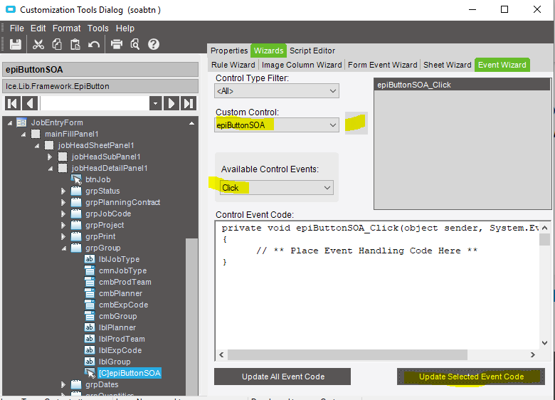

Yes it should. I used several of the wizards to generate most of the code, the only thing you would need to paste in is whats in the epiButtonSOA_Click event (after generating the click event with the wizard). I’ll post some snips here shortly.
Add references:

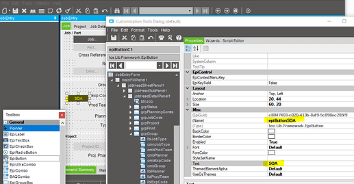

Create button with toolbox (i renamed my button epiButtonSOA):

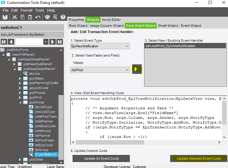

Add epiViewNotification for JobProd table (this will generate code for the dataView we pull the order number off).
Create click event for newly made button:
Paste in code above post (in click event) to newly generated click event:

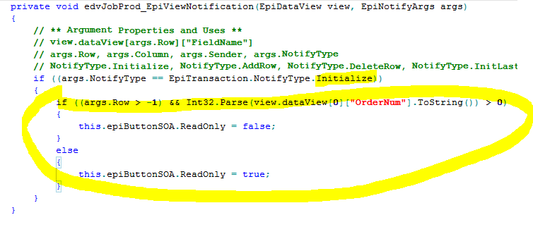

Using the epiViewNotification, you can enable/disable the button whenever a job is loaded/ not loaded. You’ll need to change the notification type to initialize. I also added a check to see if there’s actually a make to order demand link tied to the job, otherwise it will stay disabled (the check isn’t in the above code).
you’ll add the following code to the epiViewNotification:
if ((args.Row > -1) && Int32.Parse(view.dataView[0]["OrderNum"].ToString()) > 0)
			else

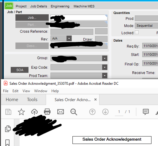

After all that you should have a working button:
