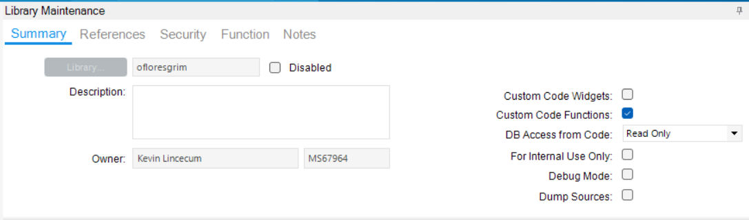

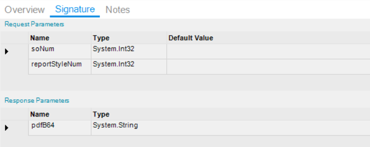

Here is you a good start.
ofloresgrim.efxj (4.3 KB)

    paramRow.ReportStyleNum = reportStyleNum;
    paramRow.TaskNote = taskNote;
