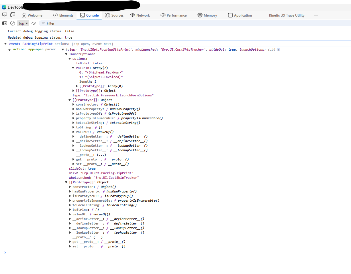

We have been using Kinetic browser for a few months without major issues. Today, the shipping person couldn’t print a packing slip. At customer shipment entry, we click on the print icon, and it should slideout a print panel, but nothing ever happens. In the background I can see this going on, so I think it is trying to show the panel, but we never see it. I never see any activity in the Network tab, when I click print.
I did this first on her shipping PC, and reproduced on my PC. Other print buttons work fine, like the purchase order print.. I can see the slideout, and the print works perfectly.

No luck! Other forms still print OK, just no slideout on customer shipment entry print pack slip.
Oh god I just checked, same boat.
Customer Shipment Entry or Tracker. Click Print button and nothing happens.
Mass Print Packing Slips seems ok.
My issue seems limited to any screen with a customer layer on it.
No custom layer on Shipment Entry or Tracker over here.
