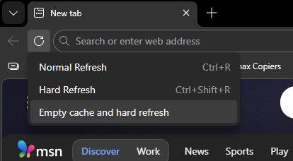

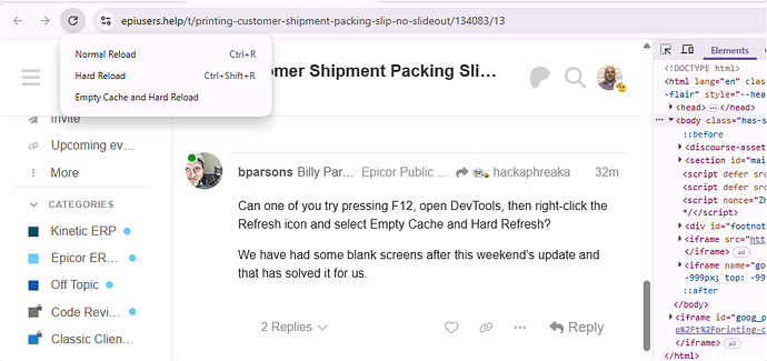

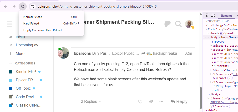

We had blank login screens for quite a few of our users this morning, and for a few blank slide-outs when they went to print things. Our TMS (FreightPOP) has some oddities after updates and they recommended running the ‘Empty cache and hard refresh’ option when the website/app gets ‘confused’.
F12 or Ctrl+Shift+I brings up DevTools, and if you right click on the browser refresh icon, you get some options, Empty cache and hard refresh being one of them. This is on Edge, I think it’s Empty cache and hard reload in Chrome, but a similar function. Supposed to clear the cache and cookies for that site alone and reloads it anew, or something like that.
It did resolve our blank screens for all users that were affected.

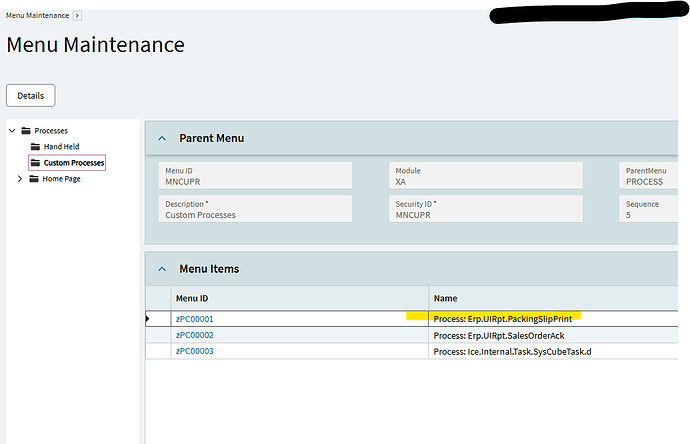

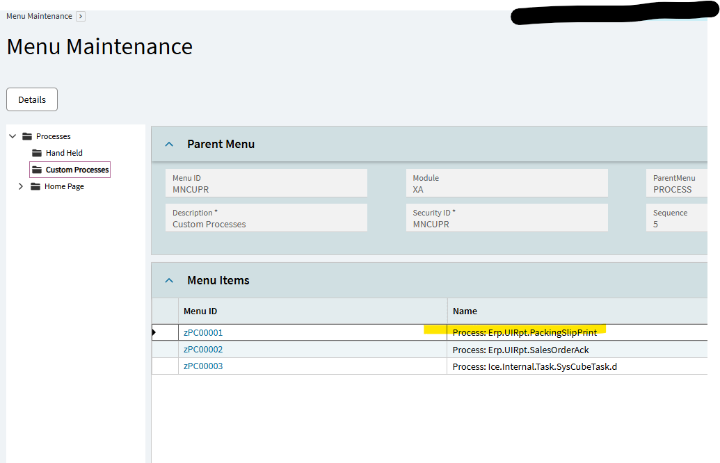

I never noticed these showing up on the menu before:
When I try and open that I get:

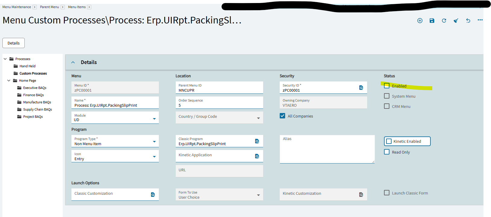

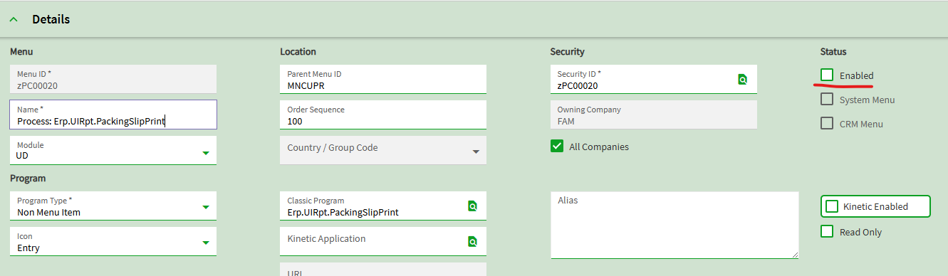

It’s actually the same issue I had with the Start Production Activity button in MES this morning.
Disabling the menu item in the Custom Processes fixed it.
Right? I never knew this!
I know F12, but never guessed it would change the functions of the Refresh button!

Disabling that menu item in menu maintenance fixed it for me.

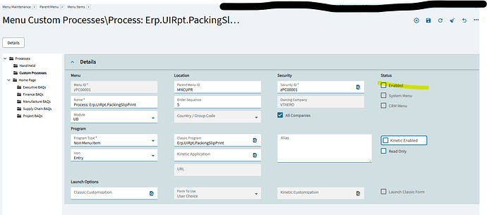

Deleted this process in Pilot, and it did not fix the slideout issue. Still can’t print.
Delete or Disable?

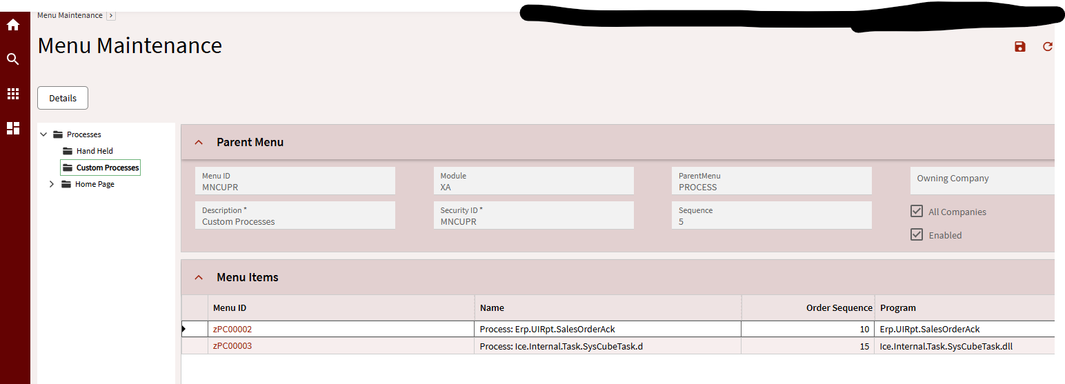

e: Also interesting you have these menu item entries too, but not as many and different menu IDs. I wonder if these are auto-generated by the system if you apply some type of custom thing to that specific activity.
I deleted the menu ID. I did not disable it.
Maybe try disabling in live and see if that does it?

That did it! Live lives!

So I guess delete != disable
