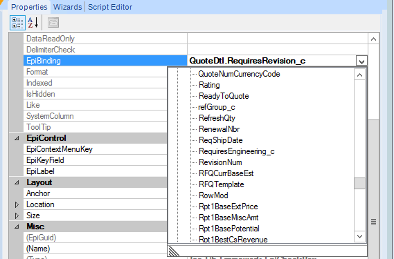

Hi all, I am having problems trying to bind customised objects using EpiBinding. My customised QuoteDtl for example will not show the UD field in the dropdown list as per the screenshot. it takes a couple of days for it to appear, I don’t know what triggers it. I have regenerated the data model numerous times, restarted the appservers, cleared the cache, but nothing seems to work. They are however visible to use on the server but even binding them there causes errors on all the clients because the fields are not showing up there. Does anyone know how to solve this?

Make sure you recycle IIS or Restart IIS on all your App Servers (if you have multiple).
