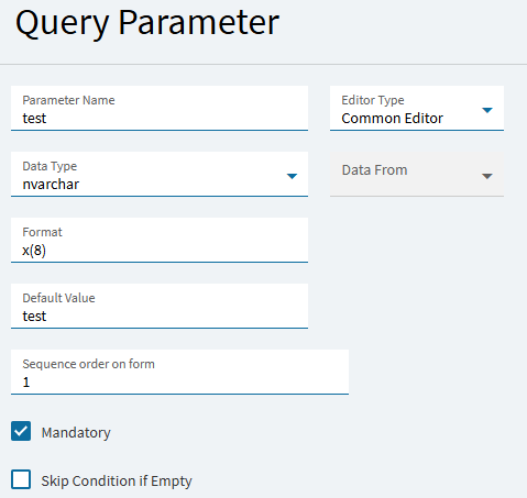

have trackers with default start dates defined, but they show up as blank when run in Kinetic. The same trackers display the default values correctly in Classic

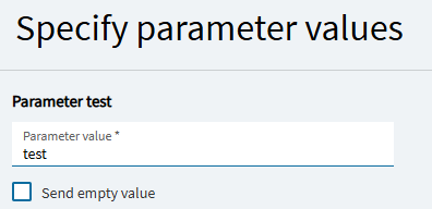

This works on 2025.1.15:

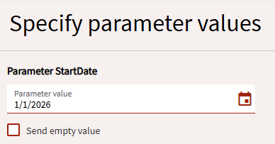

Works for a date too:
I am on 2025.2.7
parameter
Hi, My Education Environment is at 2025.2.7, I duplicated your BAQ and StartDate Parameter is working OK.
I would suggest to try another browser in incognito mode - does it happen there? If not, try to clear your cache, maybe the browser is being helpful here.

Browser cache :grimacing: strikes again. I was using Edge in private mode and the issue persisted, but magically, switch to Chrome and the default parameter shows up. Surely there must be a way to automatically “cleanse” the cache. Chatgpt says InPrivate mode in Edge doesn’t fully isolate cache!
