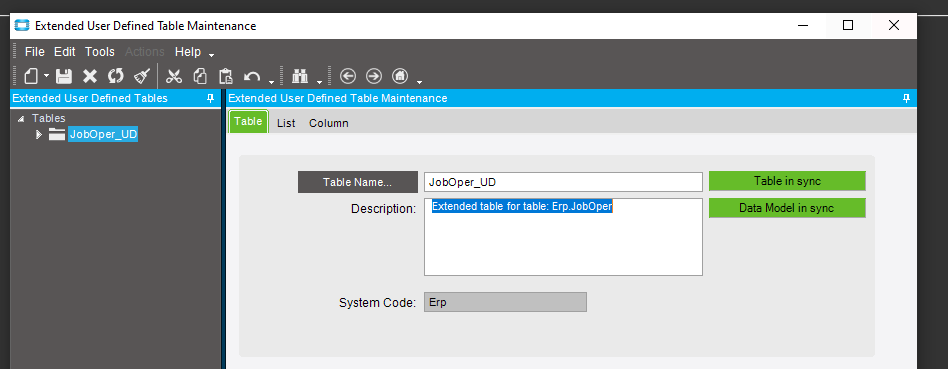

If you open the Extended User Defined Table Maintenance,
Is your data model in sync? If it’s not green and says in sync, the data table needs to be regenerated.

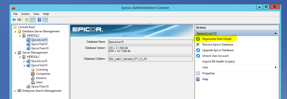

If you haven’t done it, it’s on the server in the Epicor Administration Console here:
I always restart the task agent afterwards, but I don’t think it’s necessary. It’s also recommended to regenerate the data model when the server is not being heavily used.

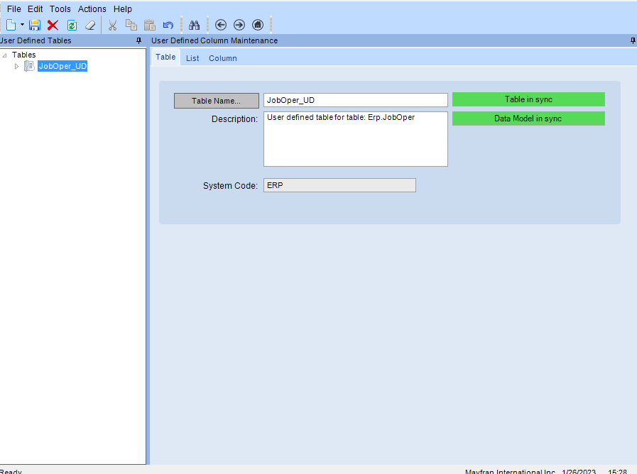

Yes, I have done that. So far, I have only seen this happen with MRP jobs.
