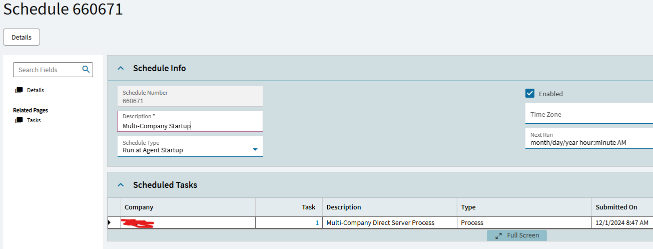

Was looking to check something in the System Monitor by another user. I went to the History Tasks, and changed it to “Display All Tasks”. There were A LOT of Multi-Company Server Direct processes. Between 15 and 35 tasks per minute. I exported the grid to Excel, and that process has run ~175,000 times in the last 5 days.
The Multi-Company Server Direct Process set to run on a schedule type “Run at Agent Startup”.

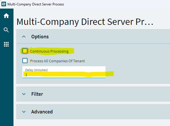

The Multi-Company Direct Server Process is generally launched at startup but when it’s scheduled, it can be set up as Continuous Processing with a delay between runs.
Right, that’s what I was going to ask Mark, I just don’t do anything multicompany even though we have two, so I didn’t chime in with a question haha.
Ahhhh so if that was set with a delay of 0, it would just start again the second it ended?
Not sure if zero is valid, but once a minute will certainly flood your logs as well!

No, that was the only one scheduled. And when I disabled that schedule, no more tasks ran for that process.
