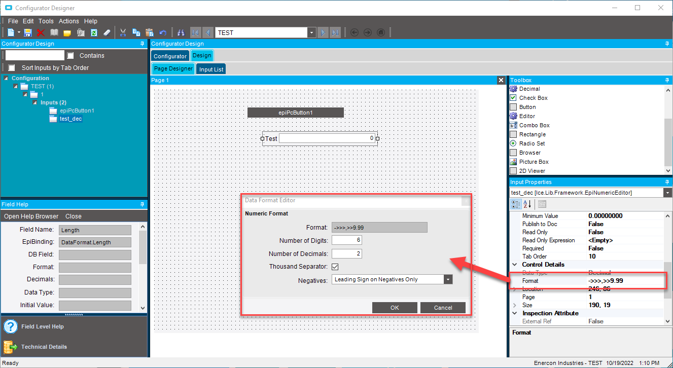

For the second (at least in 10.2.500) in the input properties there is a format option which when you click the ellipses button on the right side, opens up a Data Forma Editor that makes making an update easier.

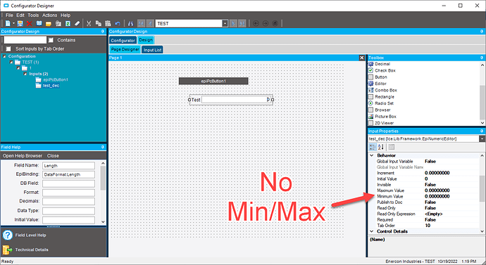

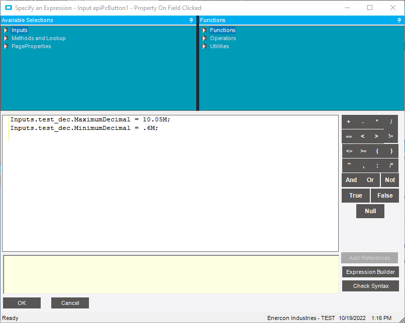

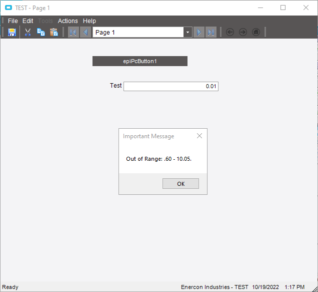

See below images
Set the Min Max with the following Code:
Test Inputs after clicking the button:
image of the code setting the min and max decimals.

the issue is no matter what combo i put in the box including the format ->>>9 all i get in the box is 0.00000
