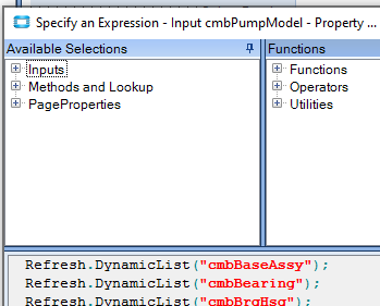

I am new to using the configurator, so by no means am expert, however maybe what we do for ours may help you with this too. On the preceding control, do you you run a Refresh.DynamicList on applicable dynamic lists, that change based on preceding control selection? This is done “on field changed” on the preceding control, like this:

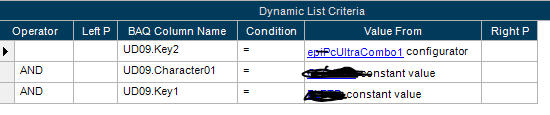

Using BAQ When I am adding the Dynamic List Criteria the value is not getting populated thats the issue.
How to add the Criteria
When I am adding first condition its working and when I add the second its working and after adding the third condition the values are not getting populated.
If try in reverse manner always when I assign the thirdor sometimes fourth condition its not working…

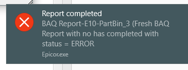

But if they exist in the BAQ, and the Skip condition if empty is FALSE and there is no default value set, the data set won’t generate properly.
For example:

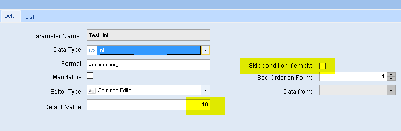

  • A simple BAQ on PartBin with Parameter:
  • A table criteria of
    PartBin.OnHandQty < @Test_Int parameter

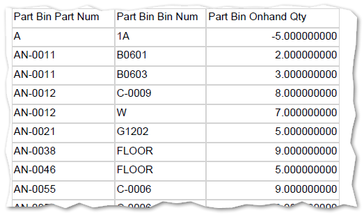

  • Made a BAQ Report (no options or filters)
That BAQ Report only includes records with OnHandQty < 10.
(I.E. - The paramter’s default value is applied to the table criteria)

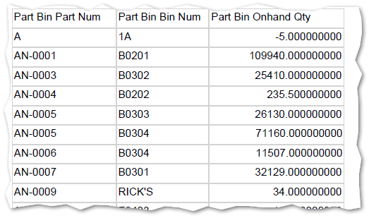

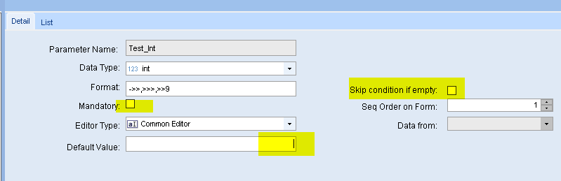

Changing the BAQ Report Param to
And re-running the BAQ Report yields a report with that table criteria ignored (PartBins with QOH > 10).
(I.E. - The paramter’s default value is not applied to the table criteria)

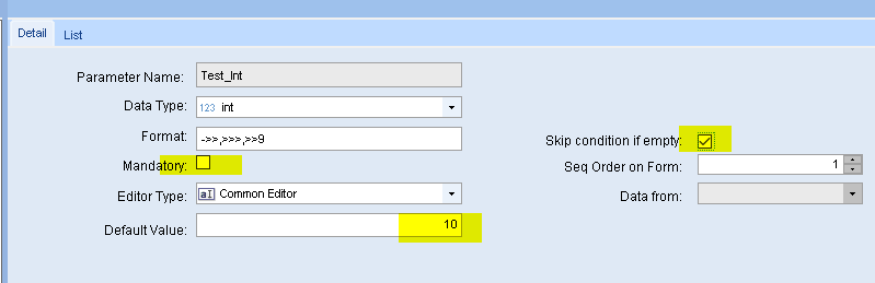

Changing the BAQ Report Param to Skip condition if empty = TRUE && no default,
and re-running the BAQ Report yields an error,
With the Sys Monitor showing:
The parameter 'Test_Int' has no value specified and empty value is not allowed.
So in a nutshell, since BAQs called by the Configurator don’t set paramters, there may conditions where the BAQ cannot execute.
