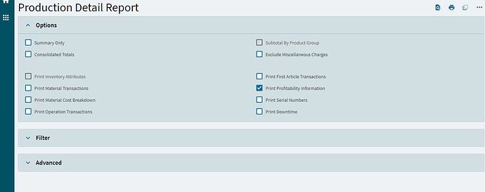

Hi, I am when i try to run the production detail report, i don’t see the check for including the Operation details. I noticed that someone else on another comment had the Operation check box on the report. We just migrated to Kinetics from Epicor 10. Is it possible to print the operation details (labor transactions) on the production detail? i was able to do it in our previous E10 version.
See below. no check box for Operation details.
Very strange… maybe it’s a permissions thing? Maybe?

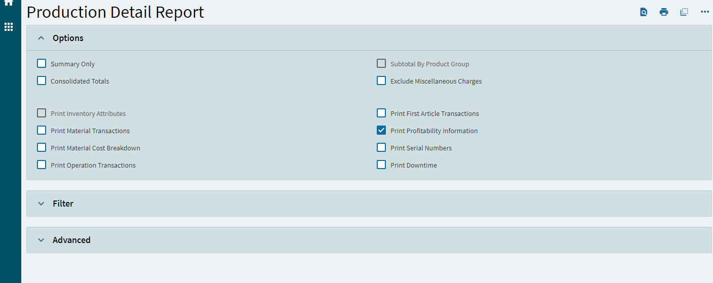

I am on 2023.1.9 and I see the “print operation transactions” when I launch it in Kinetic. Maybe try the kinetic form?
From the Field Help:
Print Operation Transactions
When selected, this check box indicates that operation transaction details will print on the report. Operation Details include all reported labor transactions and all shipment/receipt transactions for subcontract operations.
Important: This option is not available if you select the Summary Only check box
I see you do not have summary turned on. So this option should be available. Strange!
I confirm that I can see it in Classic/Modern, and in the Kinetic Client.
:thinking:
Check to see if this form has a customization. Turn on Developer mode, and right click the blank space in the Production Details Report form. If you see customizations listed there, then maybe someone modified the form to not show that checkbox (IDK why anyone would).
:rofl: Yep, it has a customization @althomas . We did it because some ops personnel were running the report and back calculating what their coworkers were getting paid… (Al, your boss asked for it :slight_smile: ). However, cost accounting security group shouldn’t be getting enabled and visible set to false on the print operation transactions box. It looks like something broke in our upgrade 9/30…
