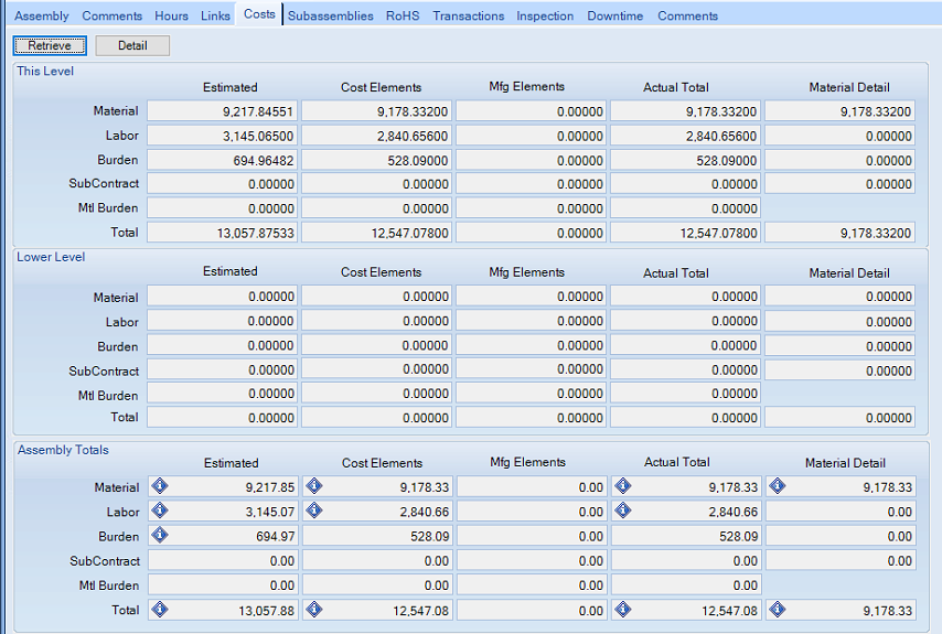

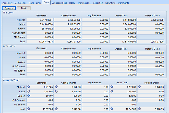

Pretty sure Job keeps track of This Level, Lower Level, and Assembly Total costs. But maybe your job processes are different than “out-of-the-box”.
I think @Michael_Ramsey is on the right track. JobAsmbl holds all of that costing. Look in job tracker under assemblies costs and click retrieve. If those are the costs you need then this should be quick.
