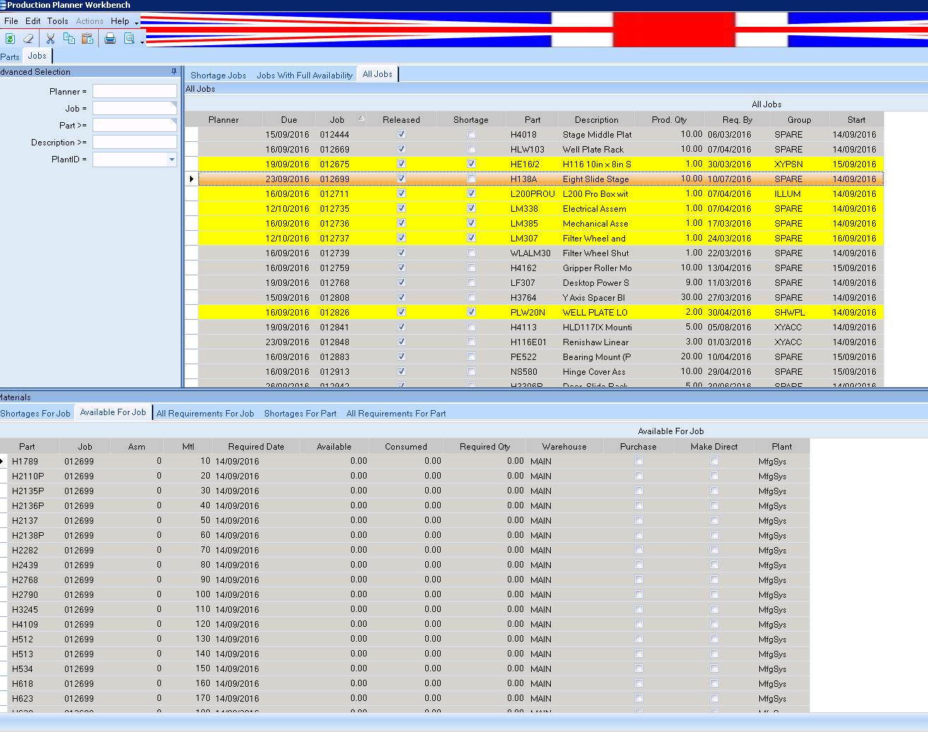

Referring to the orange line in the screenshot below…what reasons would the “available”, “consumed” and “required qty” fields not actually populate numbers?
I’ve checked that there is a BOM referring to part number H138A, and there is.

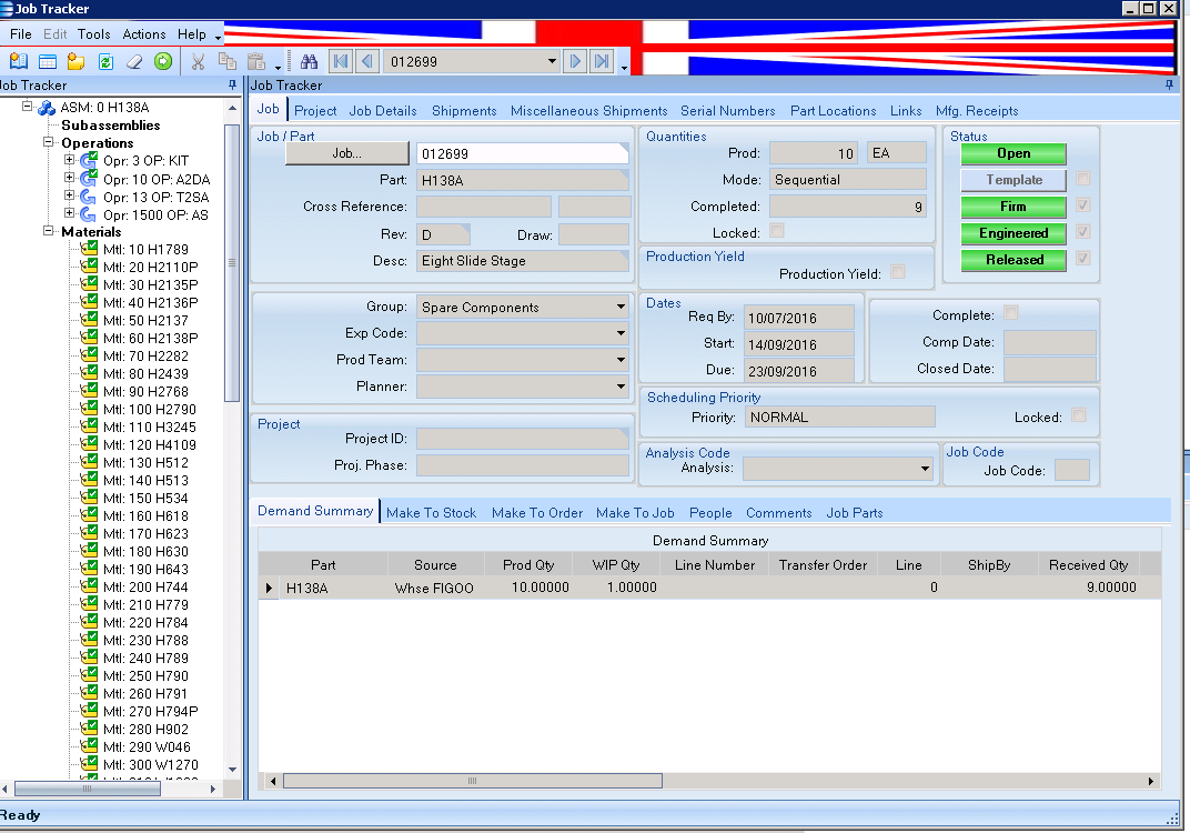

What does you Job look like?
This dashboard is using the table PPlanMtl.
Ref below from the data dictionary…
Required Quantity per END ITEM. This is a calculated field. Calculated as (Parent Required Qty X QtyPer) + calculated Scrap. The parent quantity is either the JobHead.ProdQty if JobMtl.AssemblySeq = 0 or (JobAsmbl.RequireQty - JobAsmbl.PullQty) if JobMtl.AssemblySeq > 0.
I should have pointed out earlier, this occurrence seems to be for most jobs, not just the one I’ve indicated…(so the columns available, consumed and required just don’t seem to populate in the workbench).

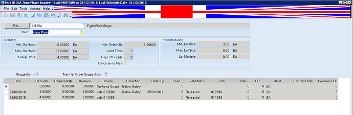

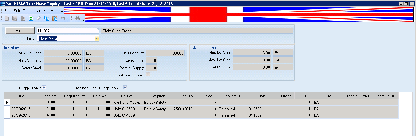

We’ve had problems with material requirements being spotty when user adds more materials to a job that had been scheduled once and then didn’t reschedule the job. The materials have demand with no demand date in timephase. Could this be your problem in planning workbench? Does timephase look the same for the missing parts as the parts that have appropriate data complete?

I’ve just re-scheduled it and it made no difference to the “available”, “consumed” and “required qty” numbers in production planner workbench. (still all zeros).
I wonder if your different warehouses are coming into acct. I see on the job screenshot you are pulling from FIG00 warehouse but your PPWB shows part availability information for Main warehouse. Could it be that the PPWB only shows materials that would pull from job warehouse being made to or something silly like that?
