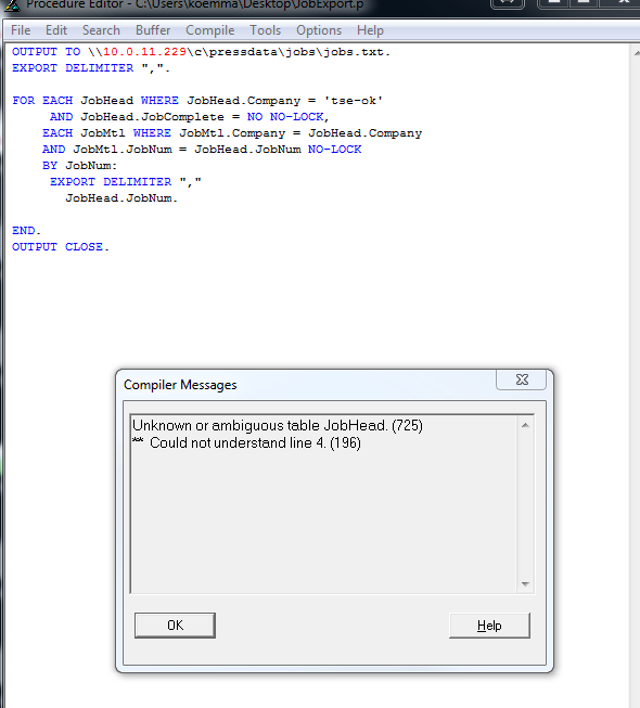

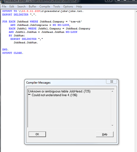

# Progress 9.1 | Procedure Editor :: Unknown Table **Category:** [Vista/Vantage 8](https://www.epiusers.help/c/vantage-8/8) **Created:** 2016-09-28 16:43 UTC **Views:** 962 **Replies:** 3 **URL:** https://www.epiusers.help/t/progress-9-1-procedure-editor-unknown-table/35627 --- ## Post #1 by @tse.dba I have a script that I created in the procedure editor. When i check syntax I get the following message. I cant seem to pin-point what is causing the issue. --- ## Post #2 by @joerojas Just a thought. Do you need to qualify the table name with PUB? Like PUB.JobHead JOE ROJAS Epicor Applications Manager VENTION MEDICAL + DESIGN & DEVELOPMENT DIRECT: 508.597.1392 x1625 | MOBILE: 774.826.9245 --- ## Post #3 by @josecgomez when you launch the procedure editor are you launching it with the db info? Your shortcut should include reference to the db you are addressing try appending something like this yo your shortcut -db "C:\Program Files\Epicor Software\Epicor904\db\Test\mfgsys.db" -S 9020 -H disraeli -N TCP -Mm 4096 -H host -S port -------------------------------- or -pf "file.pf" its been a while... --- ## Post #4 by @tse.dba My current shortcut is this: V:\PRGS91D\bin\prowin32.exe -db v:\mfgsys61\db\mfgsys.db -N TCP -H tsevantage -S 6100 -p c:\jobs\jobexport.p --- **Canonical:** https://www.epiusers.help/t/progress-9-1-procedure-editor-unknown-table/35627 **Original content:** https://www.epiusers.help/t/progress-9-1-procedure-editor-unknown-table/35627
