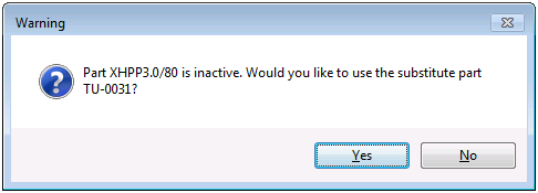

If the original P/N is inactive, you get the option to use the default alternate:
Selecting Yes will enter the alternate P/N into the form. And life is good.

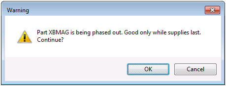

But if the old P/N is just set to run out, but not yet inactive, you get:
Selecting OK loads the old P/N. Not good. Any way to quickly replace that old P/N with its alternate?

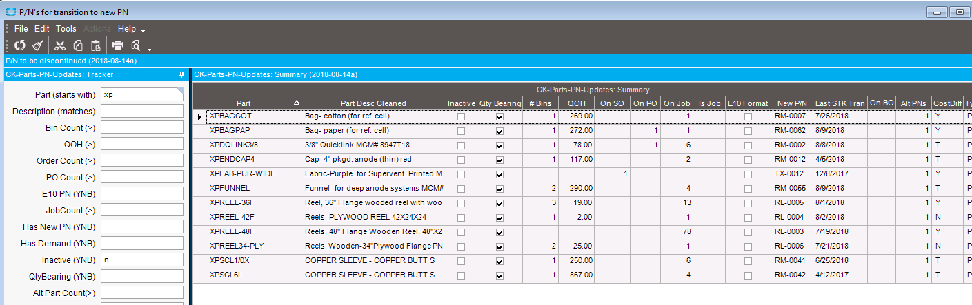

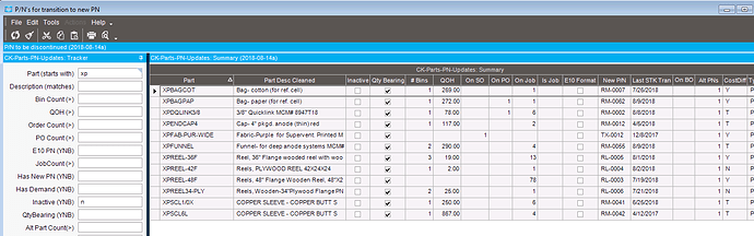

I made a pretty neat BAQ to show the old parts, with their QOH, # of bins, where demand exists, if the new part’s Cost is diff, etc… [ pats self on the back ]
But as you can see by the 2nd row, there was usage just the other day (probably from a job that was created a few weeks ago) :face_with_raised_eyebrow:

It seems that the easiest solution is to have the user click OK in the “Warning” dialog (which will load the old p/n as you said) and then click the substitute part button immediately adjacent to the rev field to display a list of substitute alternate parts for the old p/n. That method fits your preference for “something the user can just do”, it’s immediate, and it’s EASY (except for the diva user who will complain… "You mean I need to click another button?!? Can’t you just program something for me?!?). Is there some reason why that can’t work?
I didn’t know that was there! That will be helpful.
Not that i didn’t think it would work, but more so because I didn’t know it existed !
