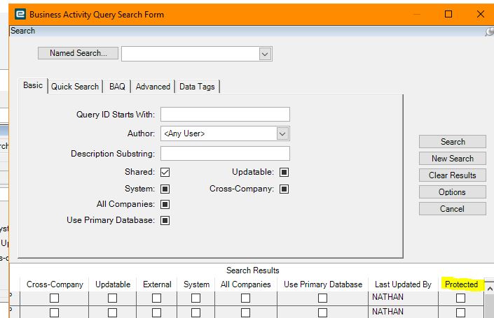

What is the “protected” field for when looking up a BAQ name? I exported all my BAQ names and info from this form, and noticed that protected field at the end. What sets it?

I still don’t see how that flag gets set. I can assign a security ID to my BAQ but that doesn’t set the protected flag.

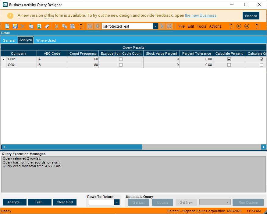

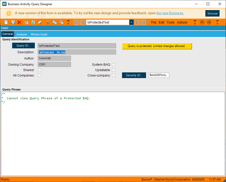

Kinda neat, though. (Set this one via SQL)

Doesn’t even seem to be that since it actually does something. Just not sure how to set it without cheating.
The fun part about this is, even though I’m the author and have God-mode in Epicor, I can’t do anything to this query anymore, lol.

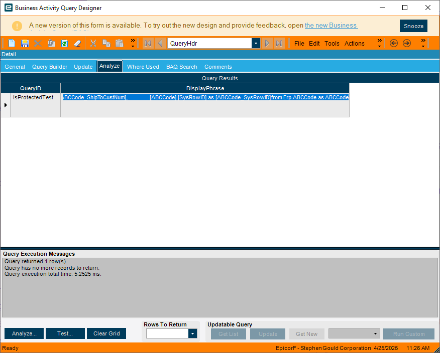

I don’t have any protected BAQ’s. :cry: So I can’t rabbit hole. What happens if you look up QueryHdr.DisplayPhrase?
It’s interesting that you can run it, but they block you from seeing how it’s created.
Only UI protected, it seems.
