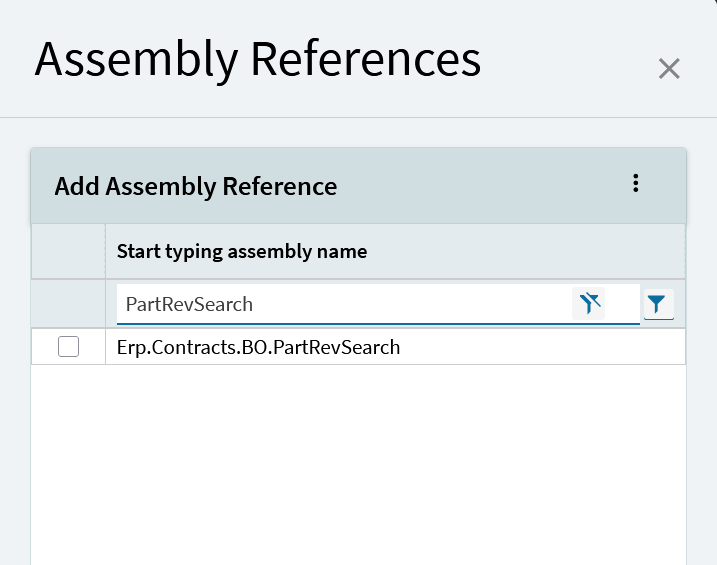

In case anyone encounters this and starts pulling their hair out, the References grid filter is CASE SENSITIVE. I discovered this after far too much time struggling to understand where assemblies were at.
Maybe result of Linux migration :thinking: , it is case-insensitive on Windows
Possibly an oversight, but could be fixed easily.

In the meantime, I made a little BPM to improve the situation. :slight_smile:
EDIT: Made a better, faster version!
The below works well, but the edit I posted works better.
Pre-Processing on Ice.BO.BpMethod.GetAvailableReferencesWithFilter
CallService<Ice.Contracts.BpMethodSvcContract>(bpm =>
    var refs = bpm.GetAvailableReferences(referenceGroup);
    result = refs.Where(x => x.Name.Contains(filter, StringComparison.OrdinalIgnoreCase)).ToList();
MarkCallCompleted();
