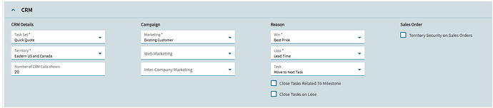

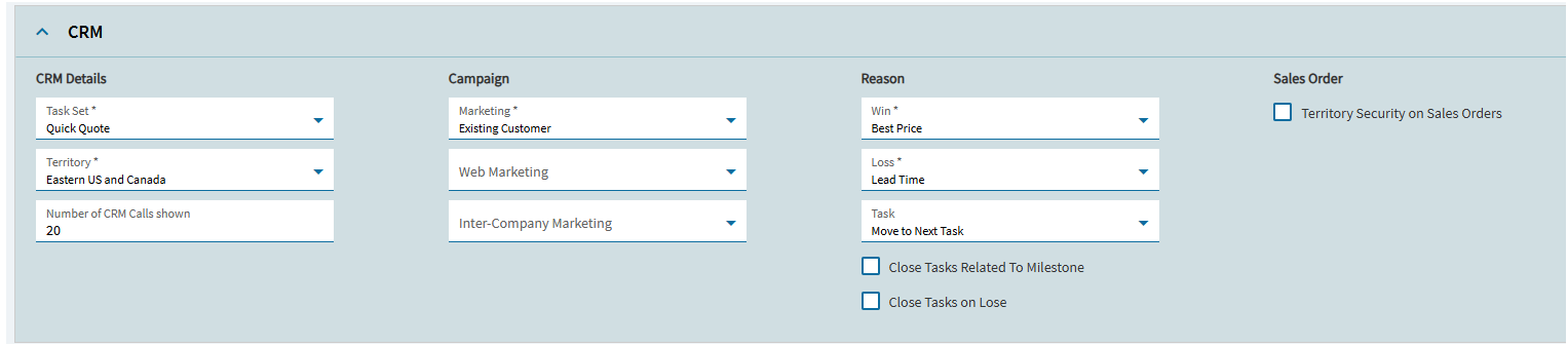

  1. CRM (if licensed) triggers all sorts of extra security checks
  • Territory is required
  • based on your assigned salesperson ID, you may or may not be able to see customer data. This extra security is enforced with all queries.. even if you make a custom BAQ, the system adds on extra filters based on who you are
  1. If you DO NOT have CRM, then everything should show as normal. no extra checks or filters.

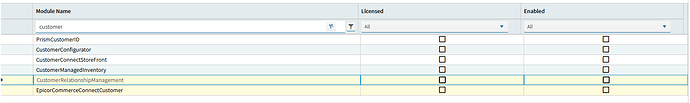

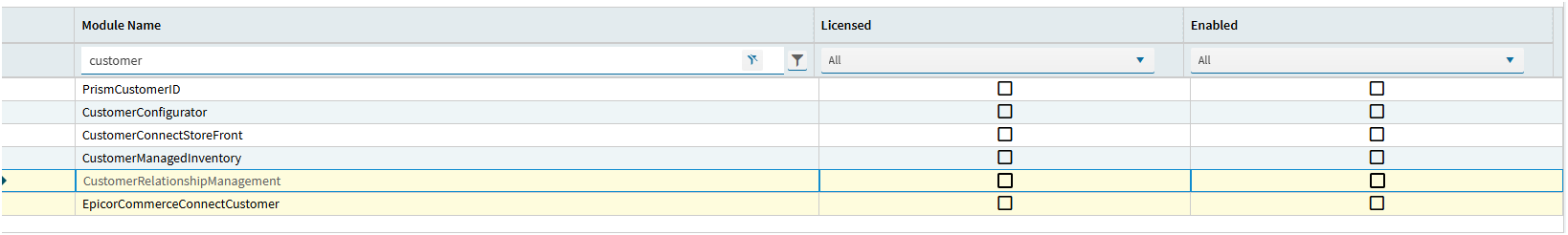

Do you guys have Epicor’s CRM module? It’s actually optional but they normally sell it in the standard bundle as if it’s required. I know Territory is required if the CRM module is enabled so that’s what comes to mind.
No, assuming I highlighted the right thing in the pic a couple posts earlier, we are not licensed for it.

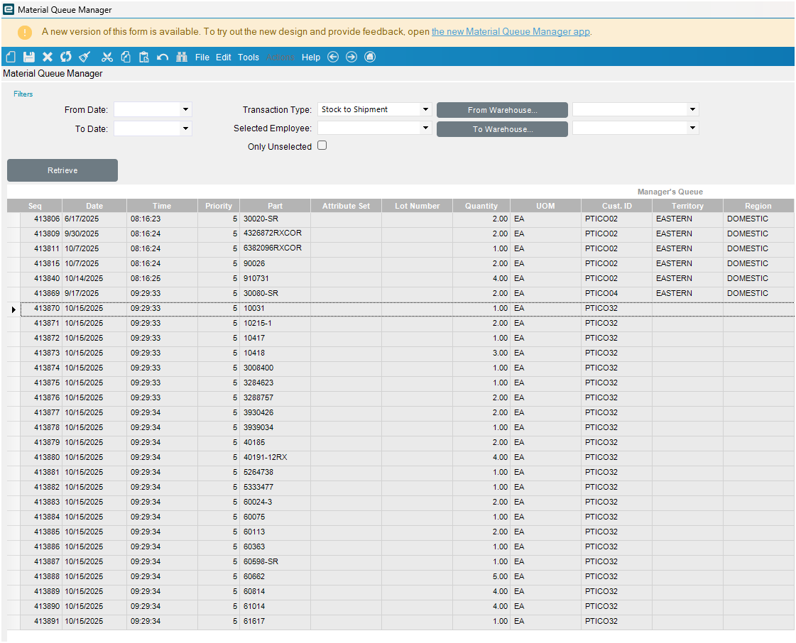

Just to preserve some sanity, here it is working in Classic. Clearly showing blank territories but still showing customer ID.
