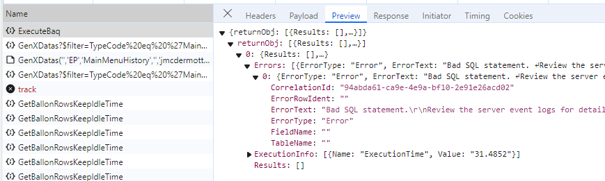

Did F12 in the browser, says something like, Bad SQL statement; check server log for error. Bogus, but OK.
Server log says, Invalid column name 'Project_BuildSequence_c'. Again, not true, but OK.

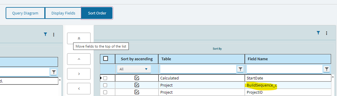

I was using that column to sort the BAQ, but I have no reason to display it in the results, so I didn’t.

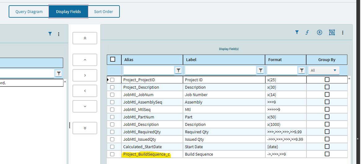

After this error, though, I added the field to the “Display Fields” list in the BAQ.
Tested it again. Guess what? It works now.

In summary, if you put the field here in the BAQ…
…you must also put it here in the BAQ:
I did not need to display the field in App Studio, though. Just in the BAQ

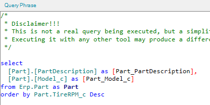

I made a BAQ identical to @GThom 's SQL statement. For that same BAQ:

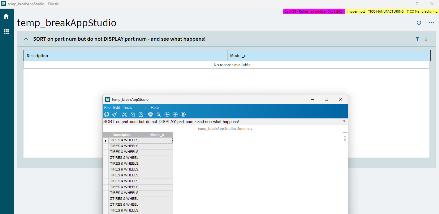

Here I modified the BAQ to sort by a UD field:

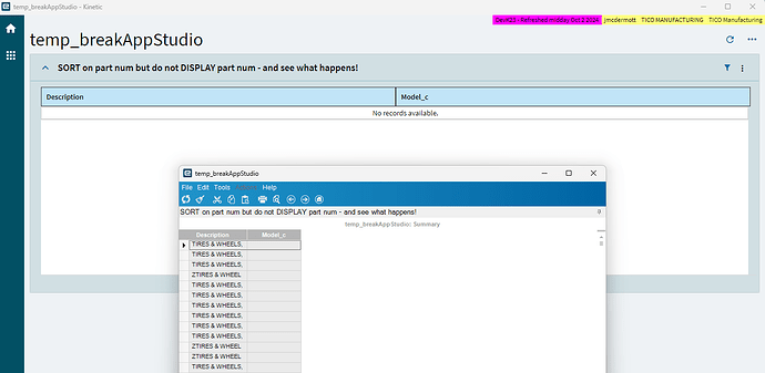

And it works in classic dashboard but not Kinetic.
And there’s the error:
That’s the difference. I didn’t try it in Kinetic. Looks like the editors are doing something different. That’s probably worth a ticket to say it works differently from one system to another. Although, since the workaround is so easy, I kind of doubt you’ll get much traction.
