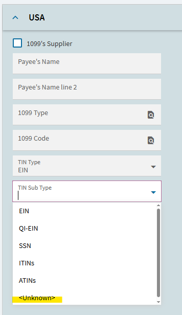

Josh, the dev team is working on making sure that this issue is resolved for the .5 patch release… but they had a question for your specific case. We are wondering if you actually have the USA CSF on your system enabled. The issue is that if you do, you SHOULD be seeing this USA tab on supplier entry. That would not be a bug. Maybe you just noticed it? the screen is required for you to set the 1099 flag and other required fields if you are in the USA.
Hey thanks for the note. I did notice the USA CSF was indeed enabled but the thing is we didn’t enable it to my knowledge.
It’s possible it was always enabled and I didn’t before notice the USA panel, but the required field error seems definately related to the .5 update because we’ve not DMT’d these fields before and we were certainly able to Add/Edit Suppliers before pilot was updated to .5
I would assume my DMT would have failed had they been required.

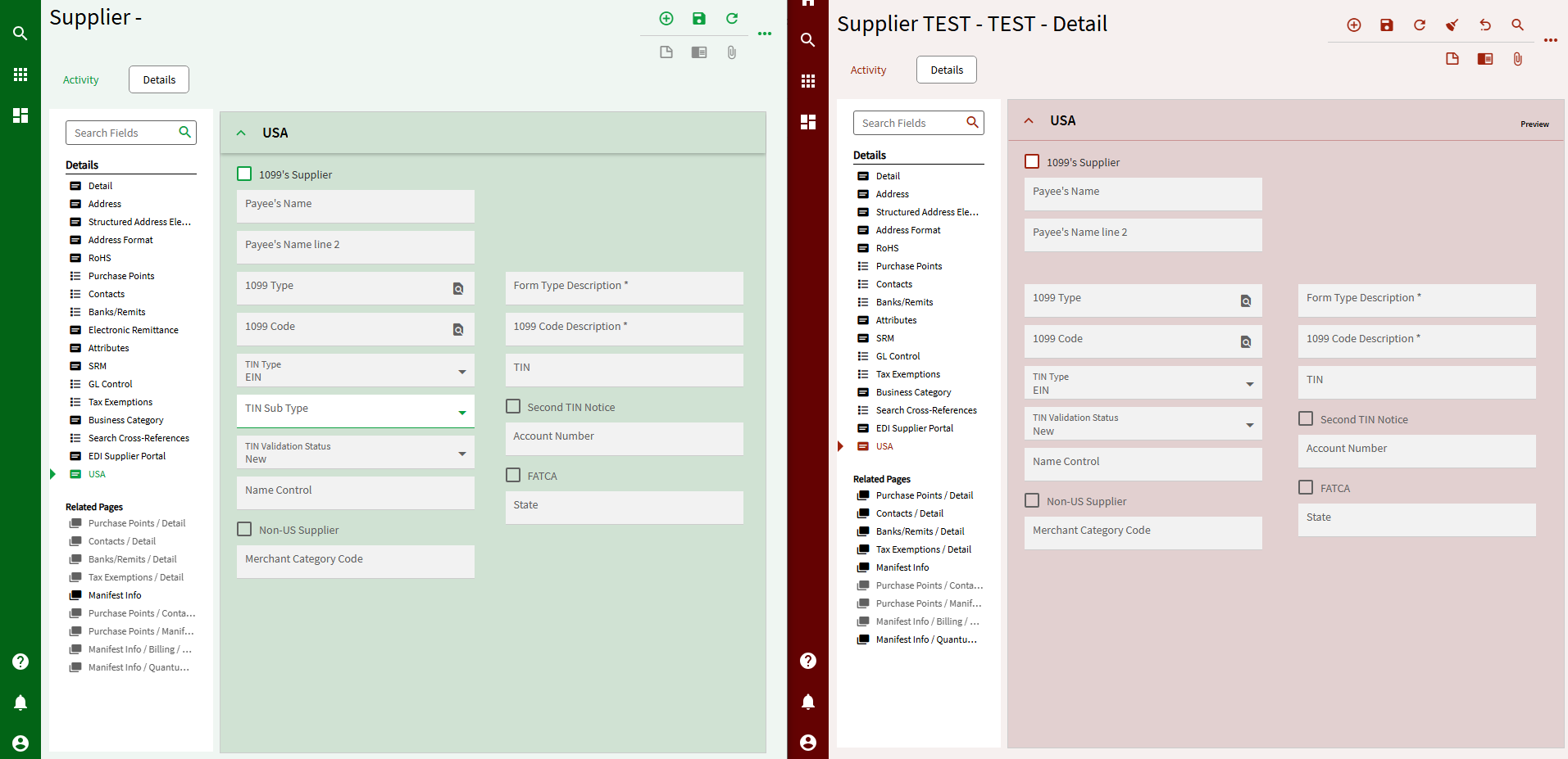

I’m thinking USA panel has beeen there unoticed since whenever it was recently introduced (says preview on my Live env) but the probkem is this new field (as of 2025.2.5) shouldn’t be enabled let alone required for Suppliers not marked 1099:
Green: Pilot 2025.2.5
Red: Live 2025.1.11
Also still wonder how this issue passed QA.

So… for electronic filing of 1099 there is a type field that must be populated in order to check the type boxes on the 1099 and the CSF team took care of the problem, adding this new SUB Type field. Since it is Required (per IRS Rules) they marked the field as required. I dont have total proof on this, but in the attempt to be transparent here, it would appear that they only tested to make sure that the field was required. They missed testing with the 1099 checkbox = false. YES, there was an error in the fact that it is only required if the 1099 checkbox is true… (This was BUG #1 - being fixed hopefully for the .5 release).
BUT there was a second “bug” in the fact that on a customer who is upgrading from a database with 1099 true, and SubType = blank, the system didn’t allow you to save without populating this field. This is not really a problem when adding new suppliers, because you would find this out as you save.
We are working on making this HARD ERROR changed to a WARNING instead of a hard stop. I have also requsted that the warning message that is displayed be more descriptive of what is needed.
But note that this does not fix the entire problem with your data. If you have a bunch of suppliers with a 1099 true, then you will still need to populate the SubType field, as this is requried by the IRS… if you submit 1099s without this, they may reject them (according to what I read last night). So… while this second “bug” is hopefully being tweaked, you still have work to do with any 1099 suppliers.

I get this problem with some suppliers on PILOT (2025.2.5). I see is that some suppliers have a default TIN Type of EIN, which then causes the prompt for a sub-type, whereas other suppliers have a blank TIN Type and those suppliers do not get this error.
The TIN Type is also showing in Classic, so its real data; but since the 1099 flag is unchecked, there is no validation error on the sub-type in Classic.
I assume the default value of the TIN Type is related to some differences in defaults which changed over time when setting up new suppliers?
TIN Type. Values are 1 for EIN, 2 for SSNs, ITINs, and ATINs and 0 if type of TIN is not terminable.
Since TIN Type is an NVARCHAR, setting it to “-blank-” or “0” for non-1099 suppliers using DMT probably would suffice.
EDIT: DMT’ing TIN Type to “-blank-” worked. Using “0” did not; apparently, an “-unknown-” TIN type is still prompting for a TIN sub-type. In any case, DMT cannot resolve the problem when creating a new supplier - it still requires the workaround.
