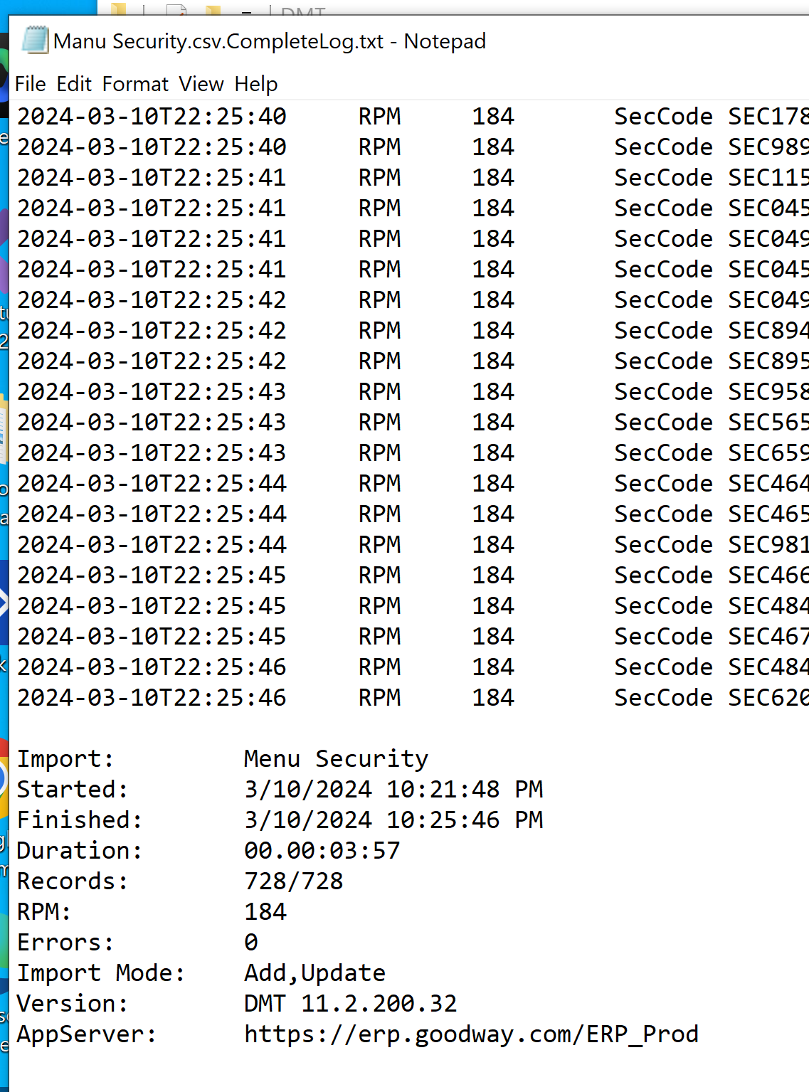

So i was able to get my security groups. But now I am getting errors when I DMT. Keeps telling me
SecCode SEC1600 Record not found.
Record not found.
EDIT: I fixed my DMT and it ran no errors but did not update anything… UGH!!

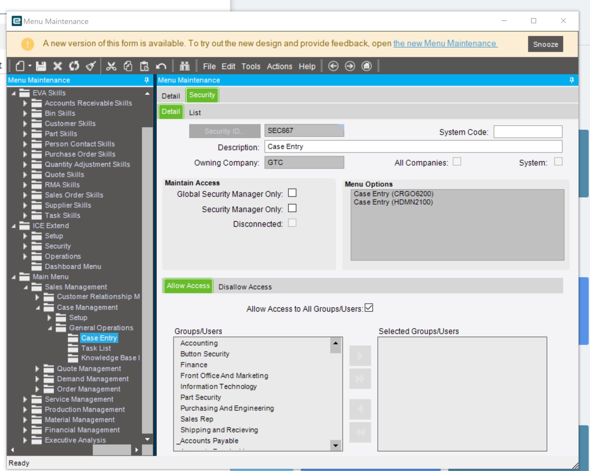

The simplest method of troubleshooting this is to MANUALLY update one of the menu items, create a BAQ to query out the updated table, then format your DMT upload file that same way.
